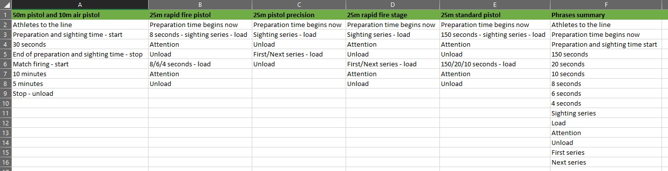

Re: Android App for 25M Standard/Sport Pistol (and others?)
I looked over the 2018 ISSF pistol training manual and identified the following minimal required calls. I also found the 2023 rules, but they are extremely more minimal, and neglect to specify 50m calls at all. And the 2023 rules omit the spoken timings, and add some words such as "For the..." and "sighting series"/"competition series". I have no idea what to make of the actual phrasing requirement.
Are these 2018 calls complete/correct? The rules do mention that competitors may recognize the calls by sound (not language), so what differences are actually customary?
