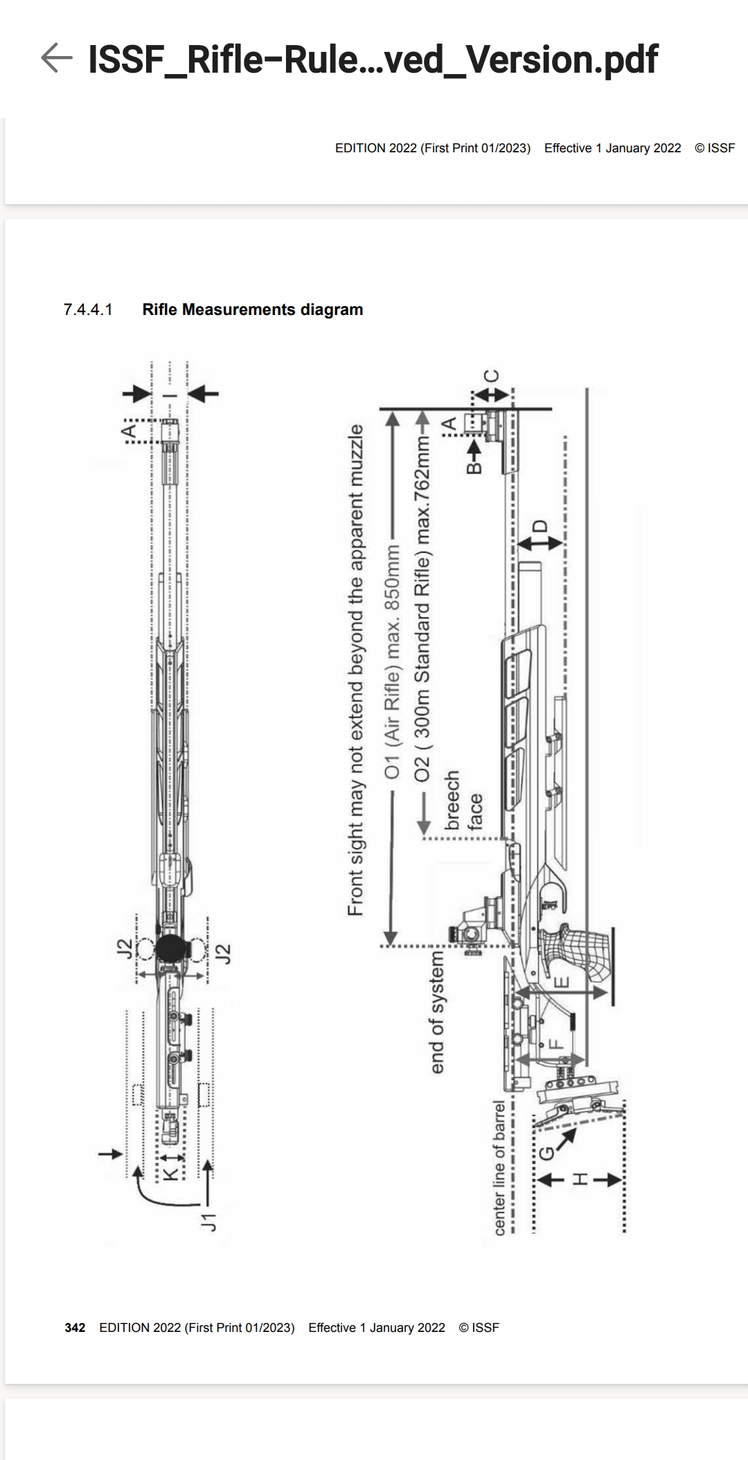

Does the body of the rear sight have to be within the 850mm length of air system? Or can it be outside this dimension and closer to the cheek piece?

Str8tshooter wrote: Fri Apr 05, 2024 5:57 pm Does the body of the rear sight have to be within the 850mm length of air system?
No, it doesn't, because sights are not the part of system (barrel + receiver, etc.).
