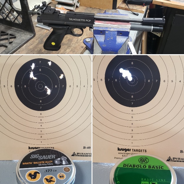

Conversationally the question frequently comes up about the pros and cons of using lead-free alternative pellets. I decided to do a semi-scientific test comparing the SigSauer wraith lead-free pellet compared to our 'standard' practice and competition pellet, the RWS Diablo Basic pellet.
1. Our 'beginner' air pistol is the Crosman 1701 PCP.
2. It was held in a 4" bench vise shown in the photo throughout the test from sighters thru the conclusion of the test ~30+ shots later.
3. The pistol muzzle was 9.2m from the target to simulate an adult male (me) shooting from a standing position, toeing the firing line.
4. The RWS pellet 10-shot series was shot first.
5. Second 10-shot series was with the Sig wraith lead-free pellets.

1. Those alloy lead-free pellets were much worse than I expected in this sample of one pistols.

They are a bit lighter that the lightest lead pellets. 6.48gr vs 7gr (light) or 8.4gr (heavy)
Maybe a bit more speed is needed to stabilize them?
They also mention that they are 20% harder than the lead ones, so maybe they need to be a bit larger (4.51 or 4.52mm) to better grip the rifling and seal against the barrel?

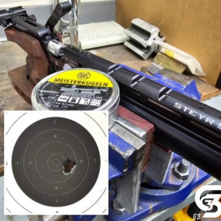

I concur with Oldnslow regarding the Match Green pellets. I've shot tens of thousands of those through my LP 50 and I've never felt it was anything but my fault when the shot didn't hit where it should. I'm not an Olympic-level shooter (as is evidenced by the following statement) but I shot a 80-shot session outdoors at 25 metres with the LP 50 and the Match Green pellets. Max spread 131 mm, mean radius 34.0. With an SSP-E (probably shooting SK Pistol Match) I managed 170/39.7 over 70 shots on the same day.
Not taking into account that 25 metres is a bit longer than they're probably made for, that would equate to a mean radius of 13.6 mm and your shots should basically all land within the 9-ring. When testing them with the pistol in a vice—a setup wherein I can only manage a distance of 6 metres—20 shots formed a group the size of which I cannot remember but that comfortably fit inside the 10-ring (they all would have touched the X-ring). Maybe when it gets warmer I can redo the test over 10 metres, shooting out of my backyard shed …
