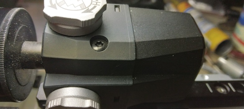

I have two of these sights, one that came with a 700 and the other an 800. They appear identical.
The question I have: Both of mine have a single philip's head screw on the right side, just in front of the windage knob. The tabs discussed above, keep the cover located while the screw keeps the cover from departing the sight. If yours 'pop off with little provocation' I wonder if the attachment screw in front of the windage knob is also missing.

I think it's a new design. Mine has miniscule plastic tabs (top, left & right) without any screw. I know there are two designs though, as SS Depot has two options.
I actually thought about using super glue or epoxy to permanently attach the plastic housing directly to the sight housing when the two replacements ultimately break like the first one. I'm certainly not going to order any more of these things.

It seems so strange to me to have the third flimsy arm go into the sight body with nothing to hold it in place. I too have contemplated gluing it or drilling and filing a hole in the sight body for the tiny bump on the third arm to snap into. The sights on my 300 and 600 series air rifles have solid sights. These on the 800 are a disgrace on an otherwise fine rifle.
