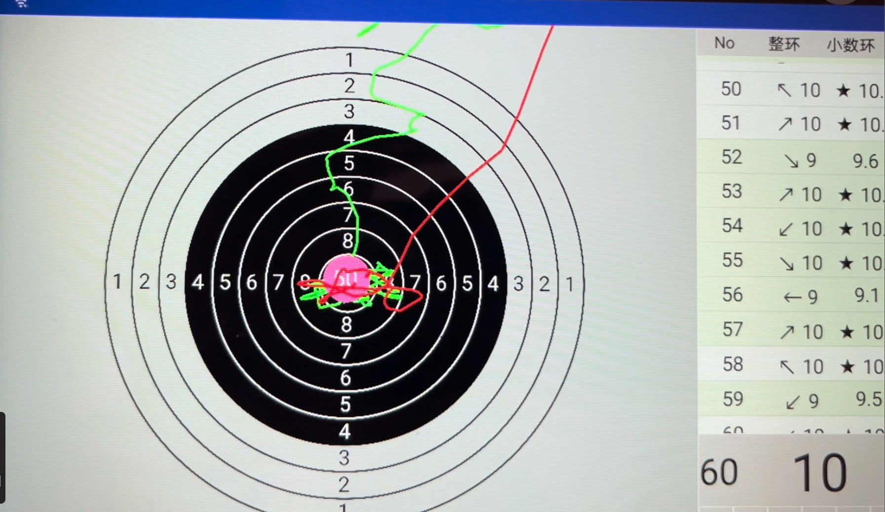

Re: How to obtain such a curve in air rifle 10m??
Post by loadcc »
Last night, I slightly twist my hips towards to the bull, and get a trace like this.
it's funny. It's get a less swing and more steadier.
10.9

Post by 400driver »
Very nice result. Well done.
