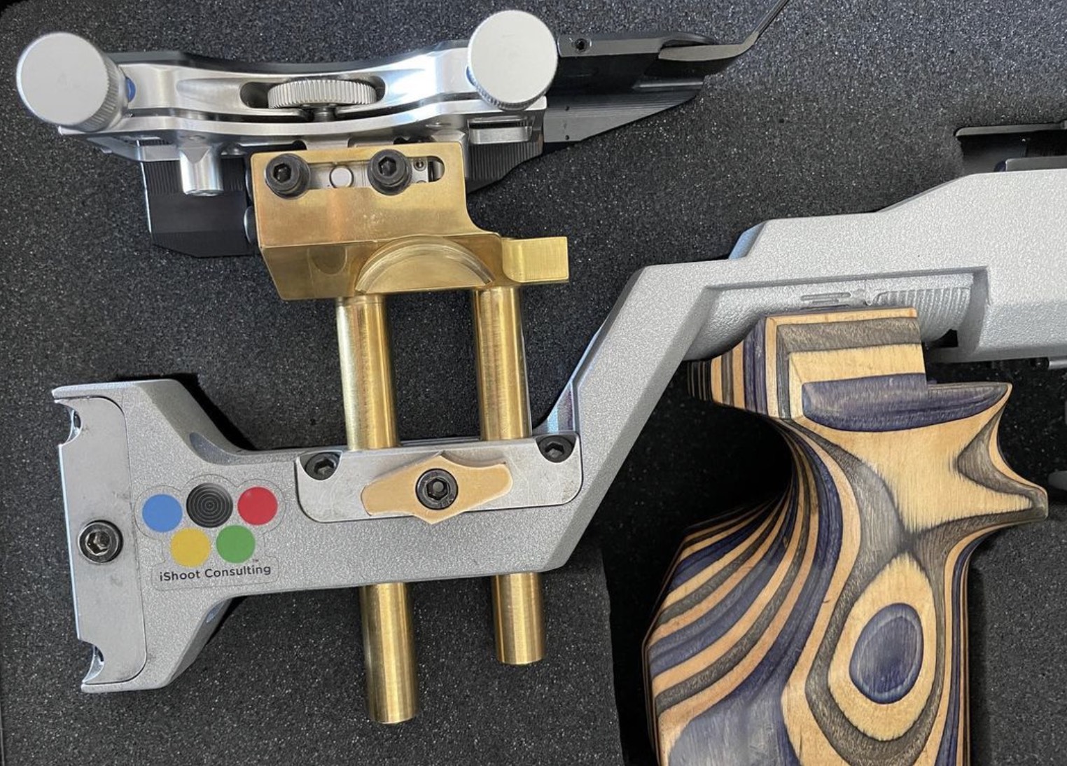

My son has the 2213, and it has been a good stock... Previous owner jumped from that stock to a G&E stock (a very nice upgrade), and honestly I think the 2213 feels better than the Precise, and the wood adds some charm (if you really want black panels, you can find them on eBay from Anschutz for $2).. As I recall one of the female Team India members has a Bleiker mounted in a 2213 chassis, so it is still a competitive base.
We modified my sons 2213 to take a G&E cheekpiece - and in many ways that brought up to the level of the 2018 or even exceeded it (minus the ruggedness of being able to throw it against a wall and not crack it).

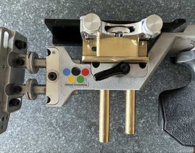

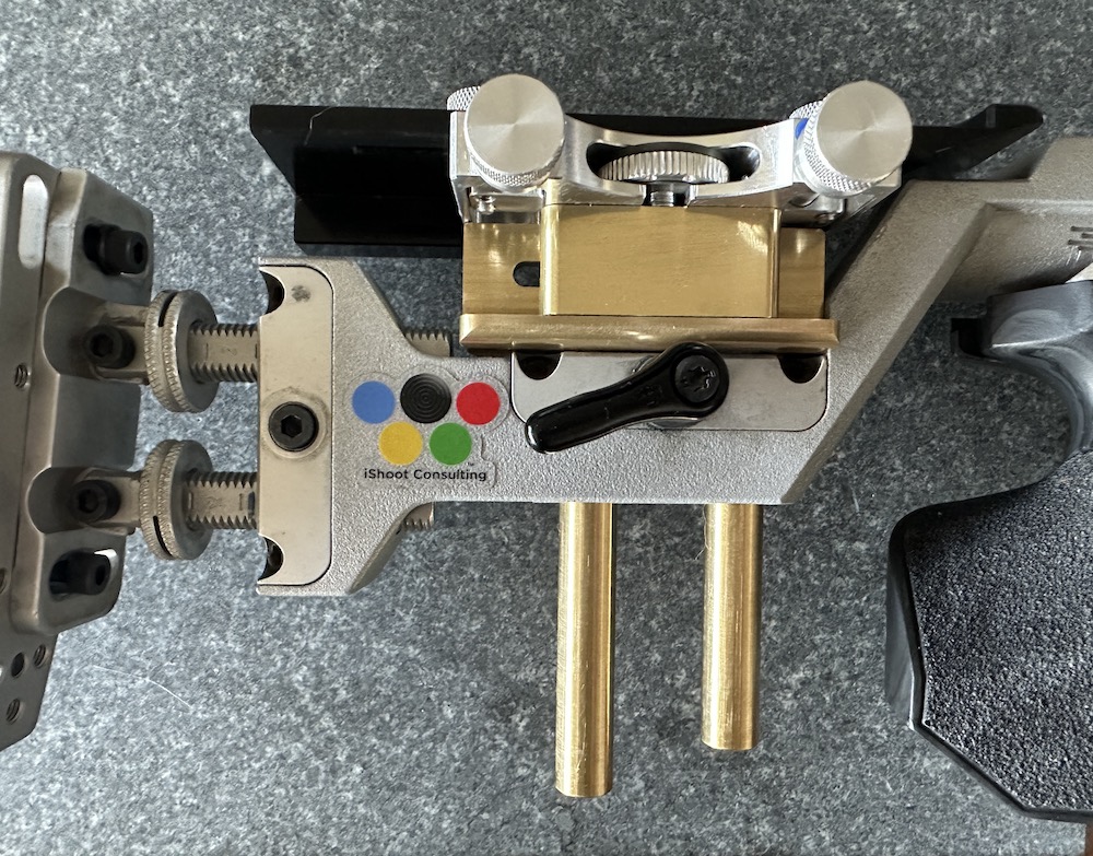

Follow up to this post.. Bought another 2213 for my sons backup gun, and retrofitted an Anschutz Precise cheekpiece to it... Moral of the story - there is still life left in these old stocks.
