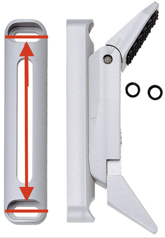

Helping somebody out, who is out of state, and is awaiting a set of calipers to take proper measurements. If anybody has a 4759, can you tell me what the center to center dimensions are for the mounting bolts, that fasten it to the carrier? If I could get overall height, that would be helpful too.

I measured mine as you show it above as : 3.700" center to center.
The threaded holes in the base that holds the part illustrated measures : 3.600".

Overall length is 4.200"
Overall thicknes to top of radiused edge to the flat back is .600".
