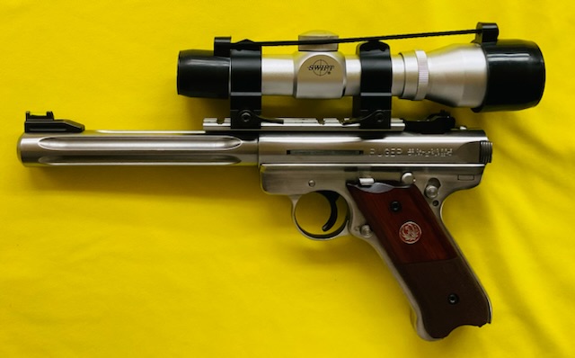

But during a hunting trip to Wyoming I needed a scope for the prairie dogs so I bought this sweet 2X Swift in Sheridan:
BTW, my eyes at 77 shoot open, dot and scope sights very well.
