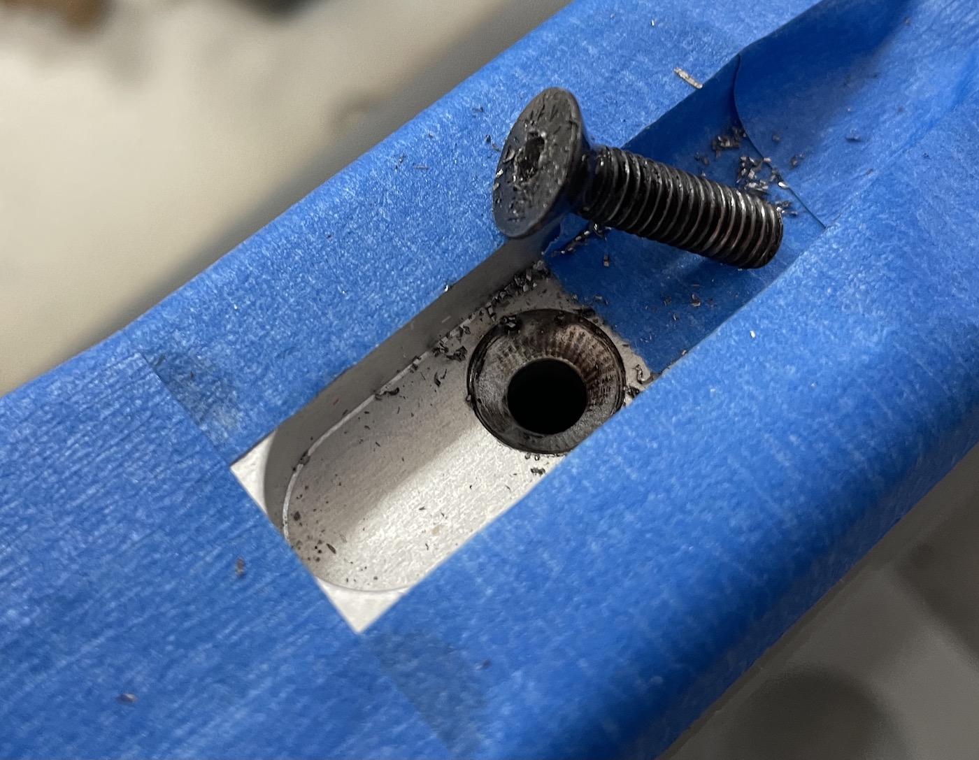

Love my KK500, I have personally seen 3 KK500 firing pins break (mine twice). Never broken one in an Anschutz. Its worth it in my opinion though, I just carry a spare with me. The electronic trigger kk's are much better than the mechanical trigger kk's. And be careful with the action screws.

Walther dosen't do a very good job of selecting the right hardware in my opinion. All of the action screws are far too small making them very easy to overtorque and strip, or even break. There are 5 to distribute the load but still. I've drilled out a few in other peoples guns before. Just be careful, I have a wood stock anatomic model, so I only torque mine to about 2.5-3 NM. For the most part, as long as you're careful and making sure the 3mm hex key is fully seated, you shouldn't have a problem.

ChickenChowda wrote: Tue Apr 12, 2022 4:54 pm Walther dosen't do a very good job of selecting the right hardware in my opinion. All of the action screws are far too small making them very easy to overtorque and strip, or even break. There are 5 to distribute the load but still. I've drilled out a few in other peoples guns before. Just be careful, I have a wood stock anatomic model, so I only torque mine to about 2.5-3 NM. For the most part, as long as you're careful and making sure the 3mm hex key is fully seated, you shouldn't have a problem.
Why not just change them to 12.9spec bolts?

GolfShot wrote: Thu Apr 14, 2022 2:09 am Why not just change them to 12.9spec bolts?
I think the issue is the the heads are a wee bit small for repeated torquing, and as with any fastener could use a little oil / anti-seize.

Totally, but you really shouldn't have to go replace all of the hardware on a 6500 dollar gun. This goes for Walthers use of fasteners as a whole, not just action screws. A lot of them are too short, and into soft materials. It was alot worse on the earlier guns (like mine) but since they have remedied alot of the issues by putting longer hardware or milling pockets to capture a nut rather than tapping into aluminum. For me I had to chuck my butt stock block into the milling machine and make those pockets myself after pulling the threads out because they had screws that were 2mm too short, straight into aluminum.
Bad fasteners is not just on Walthers. My son's Anschutz has multiple Heli Coils installed where the treads have stripped out. I don't know how these companies expect steel screws into tapped aluminum to last. Especially on screws that have to be repeatedly loosened and tightened to make adjustments based on shooting position.
