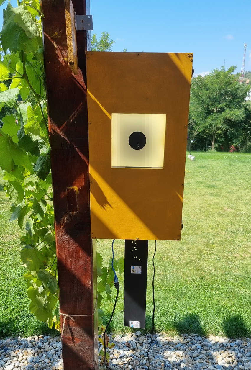

Posts: 393

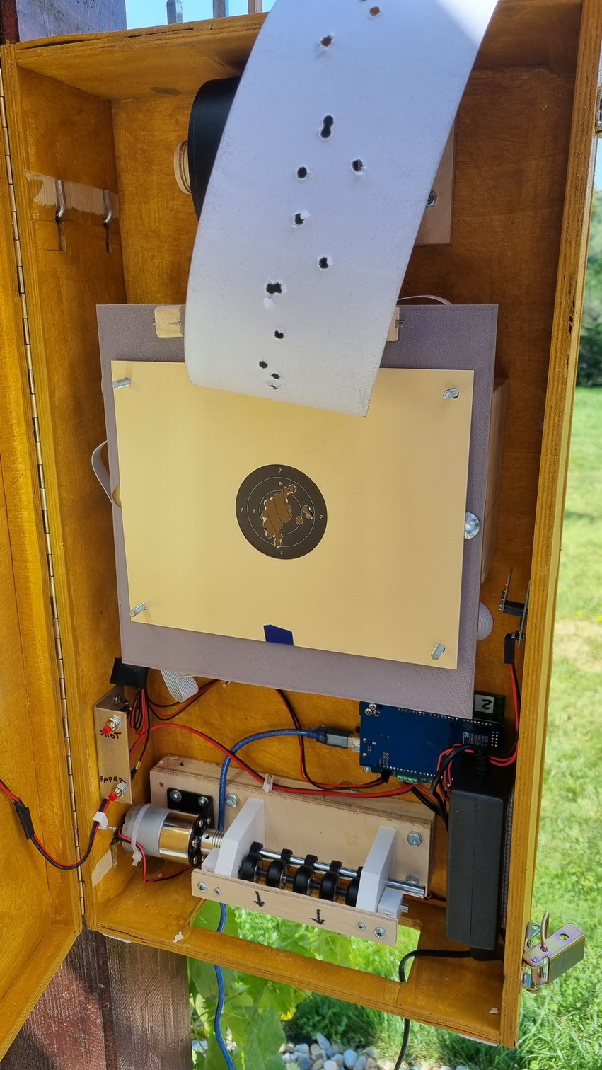

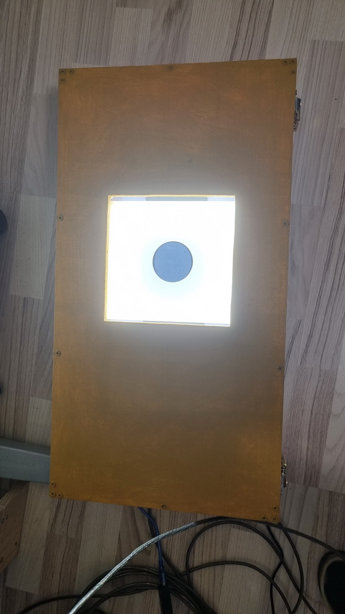

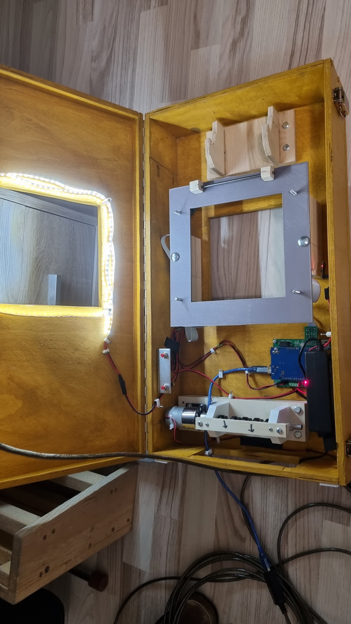

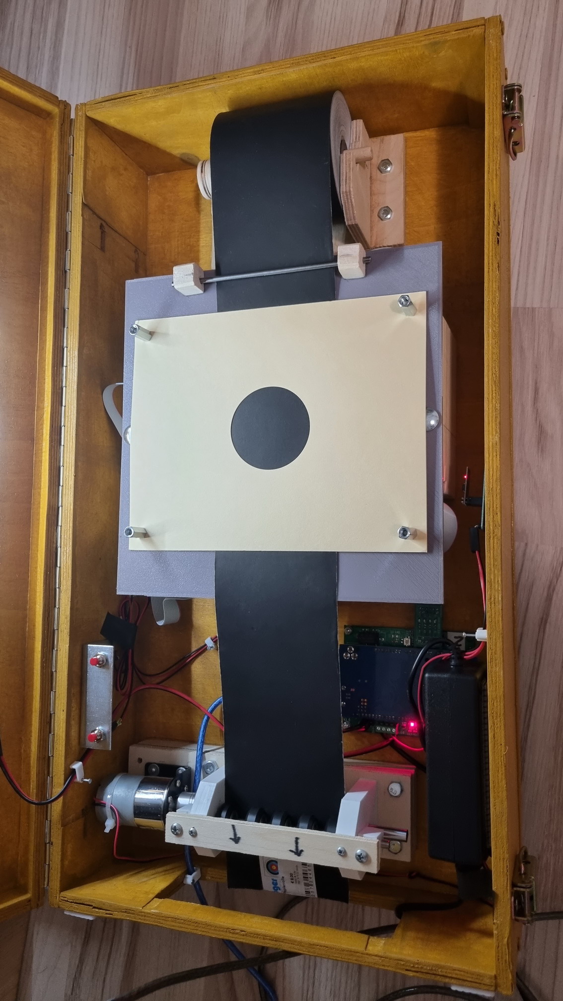

Re: freETarget
completed my second freETarget. full feature unit (with internal LED lighting and paper roll)
STP: Walther GSP 22
CFP: Walther GSP 32

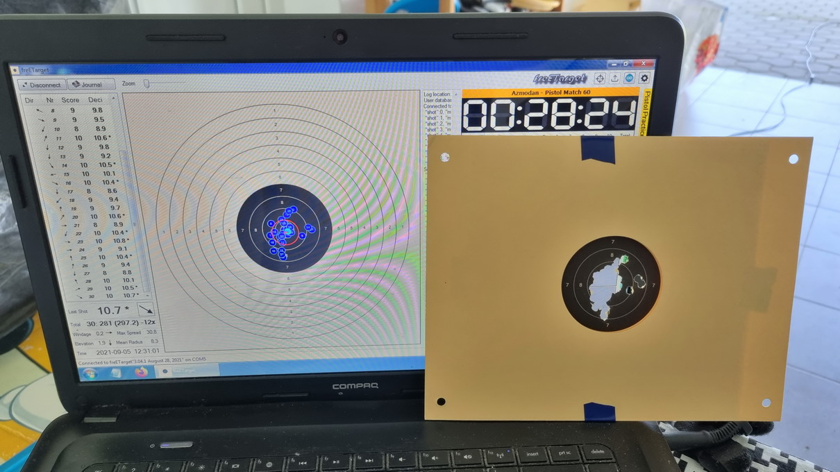

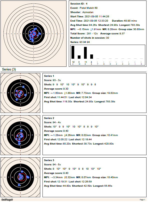

Re: freETarget
first test on freetarget with paper roll. 30 shots.
i taped a normal paper target on the back of the rear mask to check accuracy. result...good.
