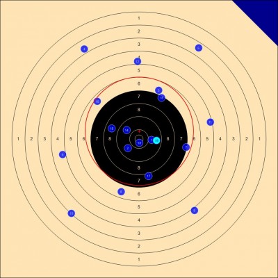

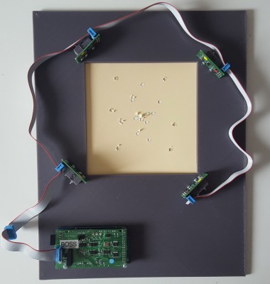

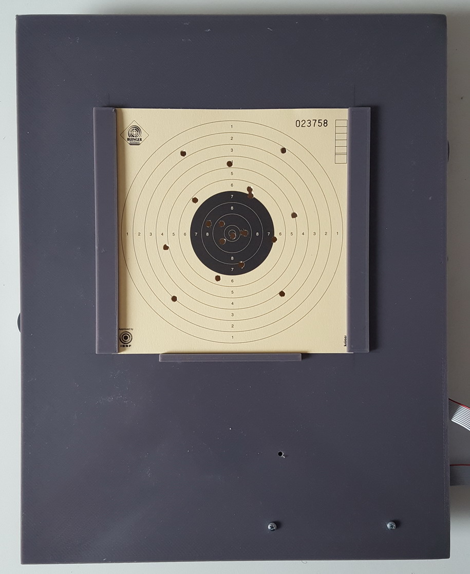

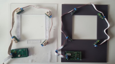

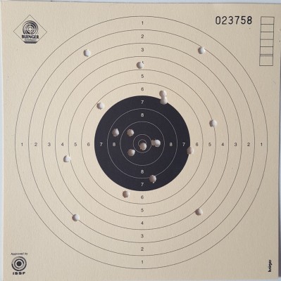

tested another set of boards together with a 3D printed target face.
accuracy looks pretty good
