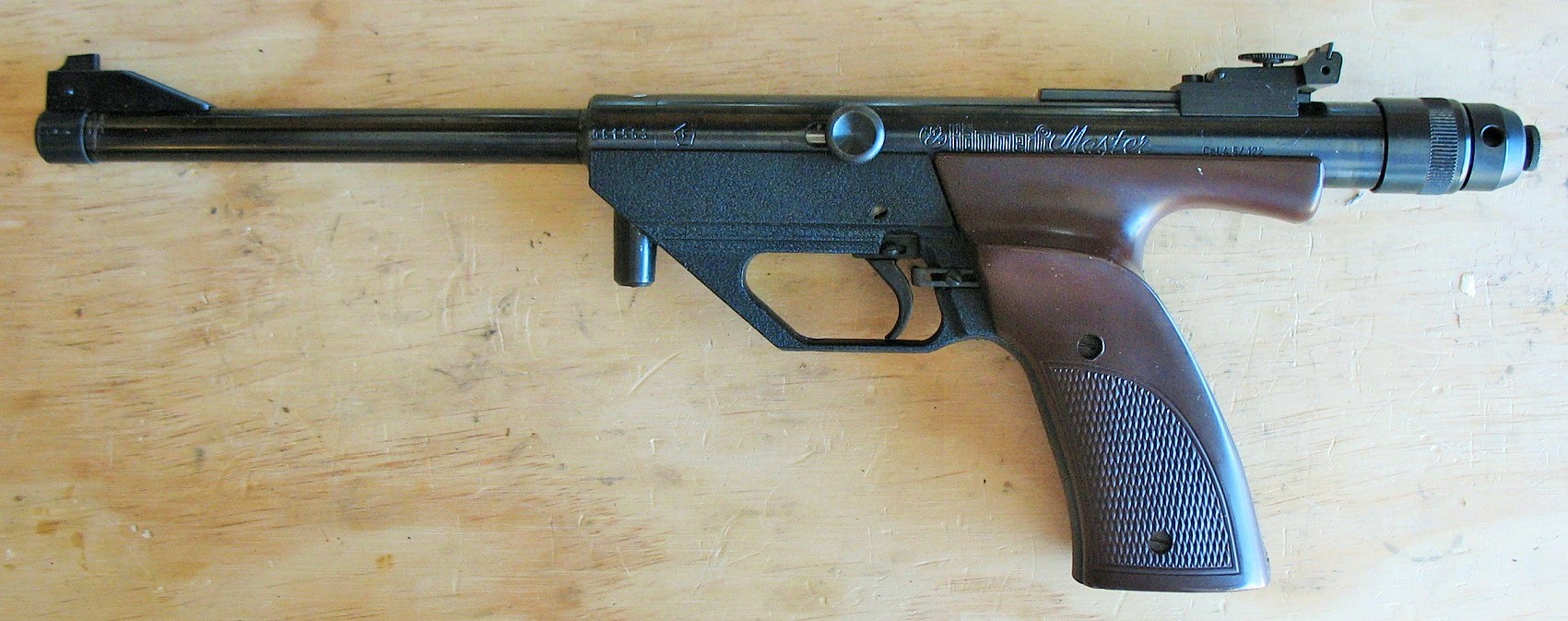

Still wanting for Match Guns tech support, hopefully they will re-open on May 13. In the mean time, I decided to take my Hammerli Master out and shoot again.

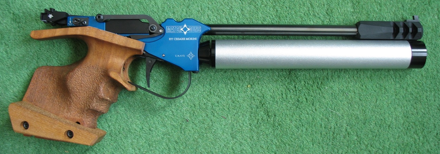

Here is a picture of my MGH1 Light. As I was posting this picture I was thinking how funny it is that none of my very inexpensive "Made in China" airguns ever failed, but this expensive MGH1failed. I won't be laughing anymore at the "Made in China" airguns again.

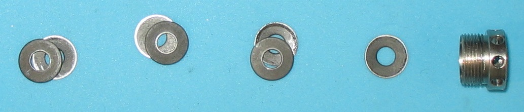

Thanks for the reply and suggestion; you are more helpful than the support I gotten from Match Guns. I already took those factory Belleville washers out and they are dry and not sticky, see picture. I measured those Washers with my Caliper and tried to see if McMaster-Carr has something close in dimension and they DON’T. I could buy a new Regulator offered to me by Match Guns for 65 Euro + 15 Euro for shipping. I don’t know if Match Guns will send me an entire Regulator for 80 Euro or just 7 Belleville washers.
Also around my MGH1’s loading port sometimes the air leak. I only had the gun for 2 years + 1 month before all these problems showed up, I didn’t shoot the pistol much cause I am a rifle shooter.
Posts: 1190
Re: Need Help to Diagnose problem with my Match Guns MGH1
The way the washers are stacked is also important.
From the pictures I think you can see the rub marks on them. They are not strait, more like a (
Steyr's washers are stacked like this ( ) ( ) ( ) ( ) and are 8 total. Macthgun's should be similar...
Hope this helps

I counted only 7 washers. They were stack like this ()()()(
Posts: 1190
I figured that much by the picture.
The way they are stacked seams correct, even if they are "only" seven.
Seams odd but without an exploded view or the pistol's parts I can't say if there is one missing.
I would check if any of them is like this | instead of (
I not seeing a way to solve it without ordering a new one. They are usually a single unit for the manufactuers and are not intended to be taken apart. I assume that Matchguns would send you a complete unit.
Hope this helps

No I don't work there, BUT the pictures are showing exactly what I was speaking of. Belleville washers slide against each other when being compressed. In your 2 left hand pair of washers, the contact surface is bright and shiny where they rub against each other.... Contrast that with the right hand pair of washers where there is obvious corrosion or congealed lube on the sliding contact face.... This means the washers will not compress and decompress predictably..... Again, they need to be degreased, polished and lightly lubed before you reassemble them...... I would go so far as to lightly burnish all of them ON THEIR CONTACT SURFACES ONLY with some 2000 grit paper doing so wet... To me it looks easily fixable with a few minutes of polishing.....
Posts: 1190
I would try spektr idea, but I woun't hold my breath on it working.
Those washers are rather stiff, and since your's is not working, I would assume that one or more has lost it's springness.
You wont make anything worse if you clean, degrease, check for burrs, and then lightly lube them.
Hope this helps
Heavypellet
Posts: 25
Joined: Thu Mar 26, 2020 2:14 pm
Location: California, USA
Post by Heavypellet »
rmca,
Thank you for your suggestion. Like I said before, I cannot find any washers with those dimension or close to it. I even tried places like McMaster-Carr.
