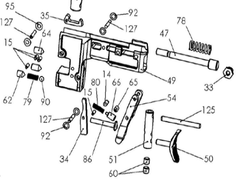

The cocking process on the AP20's gets tight towards the end, so it's a little difficult to feel the stop, but it's there. The pistols are acting as if the sear isn't quite engaging. There is no diagram of how the mechanism works, and the exploded diagram is a bit too "exploded" to see how the parts interact.
The manual talks about adjusting the "pawl", which I'm guessing is the sear. It may be that the sear engagement is too light, or that whatever stops the cocking lever isn't allowing enough rearward travel for the sear mechanism to "catch".

There is no sear in this trigger, but a blocking bar. The Striker (47) is held back cocked by the Block (35)
engaged in the groove in the Striker. The Catch Lever(34) holds the Block up until the trigger moves it out of engagement.
Things to check.
1 Back the trigger stop (overtravel) off to allow plenty of clearance.(screw F) [unmarked screw above pawl spring 79]
2 Put a couple of turns on pawl spring to ensure engagement (G) [second stage weight].
3 Cock the pistol (unloaded), slowly turn the Pawl engage screw (E) in until the pistol fires.
4 This sets the release point, now if you are going to use a light 2nd stage weight(less than 100g), back the Pawl screw (E) off 1/4 turn minimum,
(maximum 1/2 turn) this will have a little second stage travel (creep). With a heavier 2nd stage weight (100-250g), back off 1/6 turn. This has less
2nd stage travel (crisp trigger) but needs the heavier weight to be reliable.
5 Now set the trigger stop, cock the pistol, wind the stop in until the trigger won't fire. Then slowly back off until it does fire (trigger point)
then back off some more to allow 0.015-0.030" trigger movement after trigger break.
6 Adjust the trigger 2nd stage weight to feel, then adjust 1st stage weight to +500g ISSF limit.
If it were my pistol I would set weight 350/150g (1st/2nd), 4-5 mm total travel with a small amount of 2nd stage travel and 1-1.5 mm after travel.

When my AP20 stopped cocking, I found the piece attached to my striker (no number on the diagram) that the blocking bar (35) locks onto had it's set screw backed out. I had to play with how far this piece fit onto my striker and re-tightened the set screw and it functioned again. I believe this is how the velocity is set at the factory.
