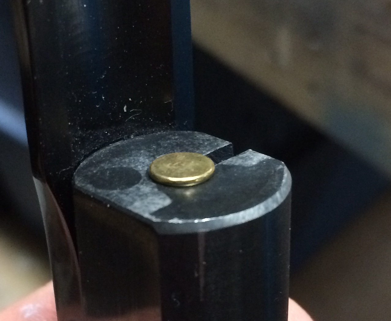

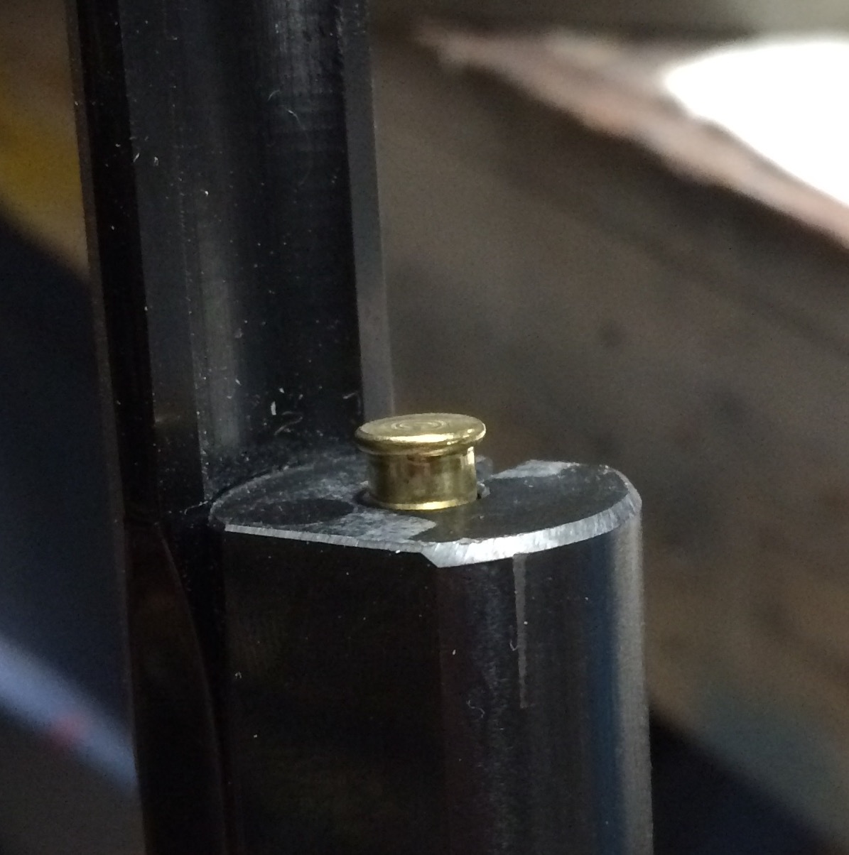

I also had a lot of trouble with CCI SV in a like new, Hamden Victor with a spotless chamber. Turns out its a CCI quality control issue. About 1/3 to 1/2 the rounds randomly chosen would "plunk" right in and out of the chamber, effortlessly .. The others would bind up half way down and result in a jam, every magazine. Couldn't get through a single 10 round mag without jamming. Switched ammo and its runs like a Swiss watch now. Ammo must pass this plunk test to function the pistol.
For the High Standard target pistols, I think the Fed Auto Match is a bit too hot, but I run it all day in my S&W41.
Try the plunk test with your CCI and get back to us. Bet its that.

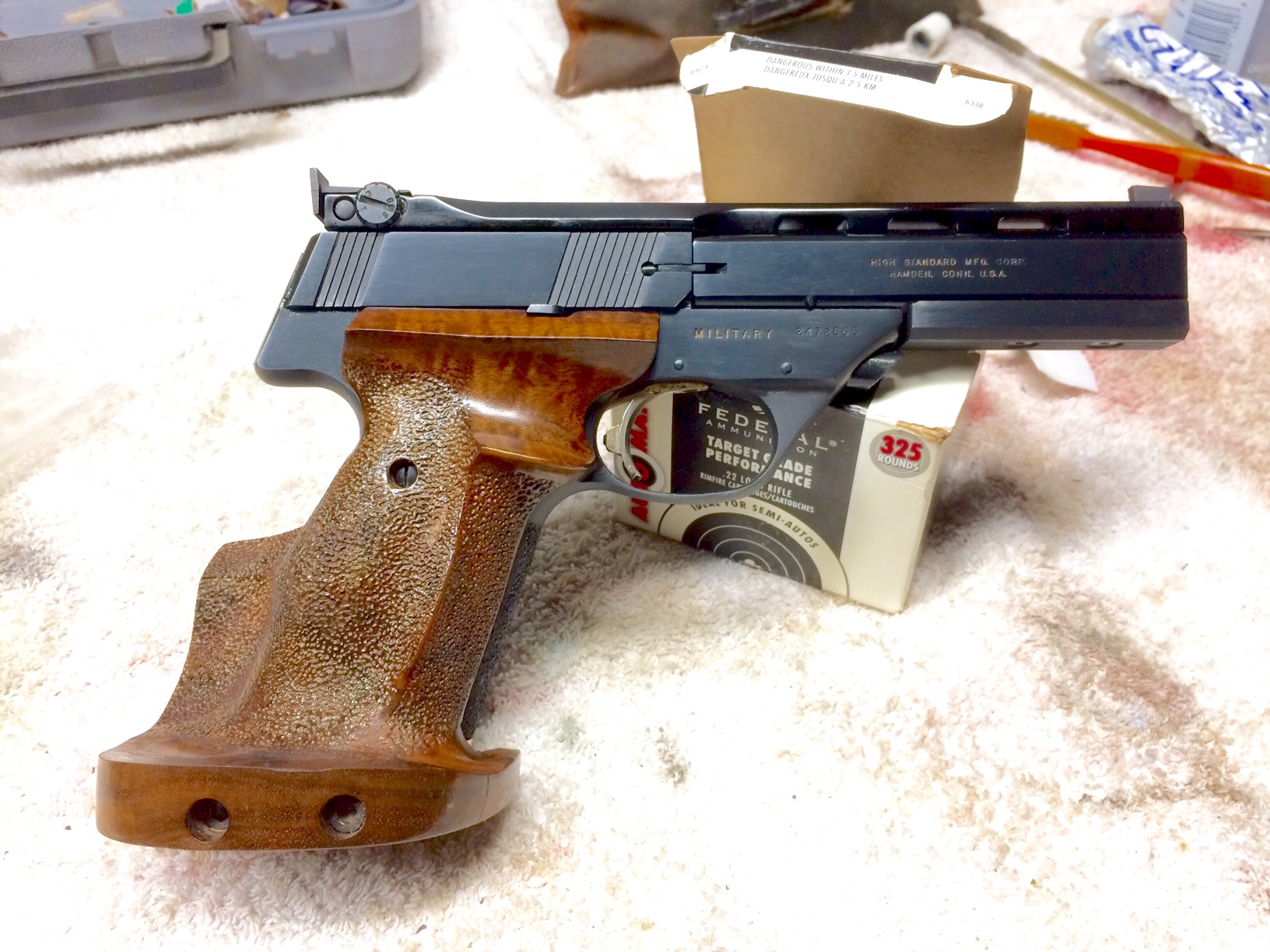

Here's a pic of the pistol. Its as new, and chamber is %100 clean and free of any dry fire dings.
The round thats not seated is one of the out of spec CCI SV rounds and has to pushed in hard, by thumb pressure. This immediately jams the gun.. Whereas the other round just plunks right in, then drops out freely as it should.
%100 quality control issue here.
