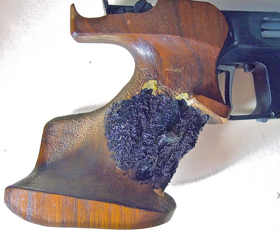

So I am wondering about taking the drimmel tool to it and get plenty on clearance. Mixing up some bondo, apply it to the grips and put nitrile gloves on and grip it. Is this how other people do it? And if you wanted some nice looking grips you could send that off and have it duplicated? Thanks

Before doing anything read what the late Don Nygord had to say on the subject of grip modification. There are 2 notes on the subject:
http://www.cincinnatirevolverclub.net/nygord.html
Then don't be afraid to have at it. I've attached a pic of the grip on my Pardini SP. It's hard to see what with all the black. The process was careful Dremel work to get the general proportions in line with my hand, then building up with epoxy wood filler - the 2 component stuff you get in a tube that looks like either a Tootsie Roll or dog poo - gripped with moderate pressure. After it cures, check fit, grind some more, build up some more if needed. At this point I like to set it aside until the next day to calm the loony-tunes shooter's brain and to make sure the initial impressions were right. When the fit is good, I apply my proprietary non-slip treatment and seal it all with epoxy appliance paint (black was what I grabbed off the shelf at Home Depot (they love seeing me walk in so they can ask what project I've just messed up).
You can create a better fit than any Euro manufacturer can do at a fraction of the price. But if you insist on spending the money, when I owned a Benelli Kite, its Nill grip was absolutely the best fitting factory grip I ever held. For me, Rink just doesn't work.
