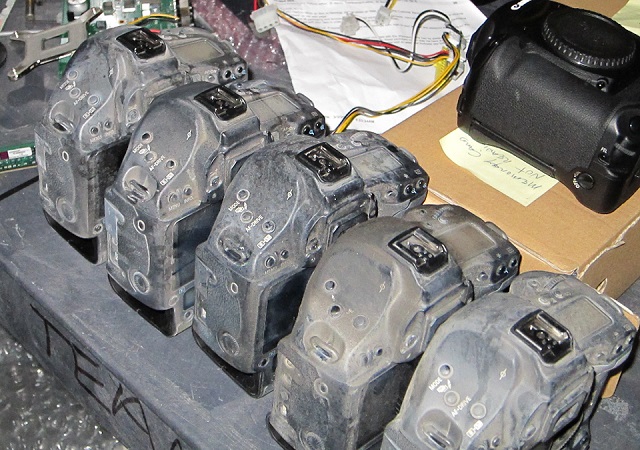

Some of the airborne lead from firearms is from the primers. So even jacketed, or solid copper, bullets aren't eliminating it. And if you live near an airport, there's a chance it's raining down on you from light planes. The gas they use is loaded with lead. I heard somewhere the 'low lead' has 5x the amount of lead even the highest auto gas ever had.
Here's what it looks like on some cameras that were in a well in a Cessna. The guys working on these were somehow unaware of what it was. They quickly stocked up on cleaning supplies after I told them.
Re: Aluminum pellets
Aviation gas (100Low Lead) has .56 grams per liter.I heard somewhere the 'low lead' has 5x the amount of lead even the highest auto gas ever had.
In 1972 the regular gasoline for autos had 2 grams per gallon (or about 1 gram per Liter).
Keep pellets out of your mouth, and wash up after shooting, and the danger to airgun shooters from lead is extremely low.
But you don't have photos of dirty cameras and he clearly heard it somewhere.Pat McCoy wrote: ↑Thu May 20, 2021 9:33 pmAviation gas (100Low Lead) has .56 grams per liter.I heard somewhere the 'low lead' has 5x the amount of lead even the highest auto gas ever had.
LOL!
I'm more than happy to be wrong about that. I'm currently living across the street from the runway in an 'airpark'. I never got a license, but my dad flew for quite a few years. I remember him making up a special tool, for scraping the solid lead deposits that built up in the sparkplugs. Ugly. But at least part of that is the steady state, RPM and temperatures, they run at for extended periods.
But you gotta wonder ... my girlfriend built this house, and some of her kids seem to be developmentally impaired ... Or I'm just a grouchy old B' now.
