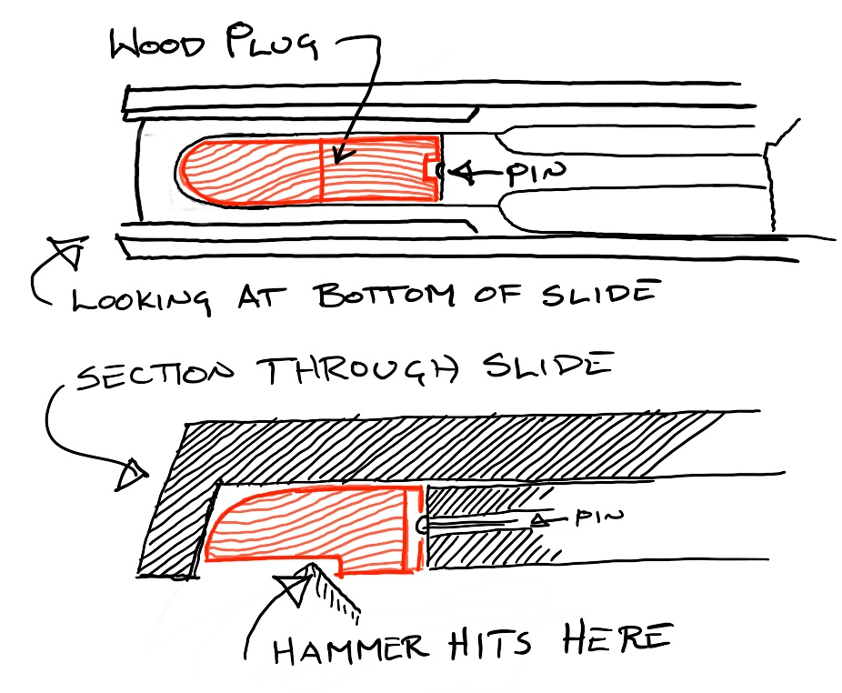

When I had a model 41 I got sick of messing with snap caps & drywall anchors. Looking online I found ideas for several other solutions, the best was a block that fits in the recess in the bottom of the slide. I don’t have one anymore, but I made several when I figured it out & handed them out like tic-tacs to anyone I saw shooting a model 41.
If you look at the bottom of the slide where the hammer strikes the back of the firing pin- the idea is to fill this volume with a plug that prevents the hammer from hitting the pin. Easy. The plug was notched on the front so it wouldn’t touch the pin & had a ledge on the bottom that stopped the hammer & could push the hammer back to re-cock. Basically I would pull the slide off & drop the plug in, then could dry fire & re-cock by moving the slide back 1/4” or so. I kept this in all the time that I wasn’t shooting on the range & found that it was so easy to dry fire I ended up doing it much more.
I first saw the idea somewhere online, machined out of Delrin or something. I had some scraps of oak in my shop, ripped it to the width & depth of the slide recess on my tablesaw & cut the rest on a bandsaw. It took 15 minutes to make like 10 of them. If I were doing it today & would make it on a 3D printer- it would use like 5 cents worth of filament. If I can lay hands on one of the oak ones I made I’m happy to measure it & make a 3D model of it that anyone could use to print them up. Find your neighborhood nerd kid to print it for you, or many libraries have printers. There are also online services that you can email a file to & they’ll mail one back.
I’m sorry I don’t have a photo of one at hand- if I get a chance I’ll try to make a sketch & post it here soon.

Here’s a sketch looking at the bottom of the slide & a section through the slide & plug. Plug is orange. The back of the recess in the slide is milled differently on old vs. new model 41’s, just make it match yours. The step in the bottom of the plug is what cocks the hammer, I don’t recall the dimensions to locate it but it is about 1/8” tall.
I haven’t had a Model 41 in years, the drawing is from memory. It should be pretty close. Hope this helps.

Here's an inexpensive fix for a dry fire plug.
https://flat5.net/writing/bullseye-2/tr ... -snap-cap/
I also remember seeing a piece like the one described in wood but made out of a hard plastic material. I think it was cut out from a piece of Delrin or similar material. Both blocks worked and stopped the hammer from striking the firing pin.
