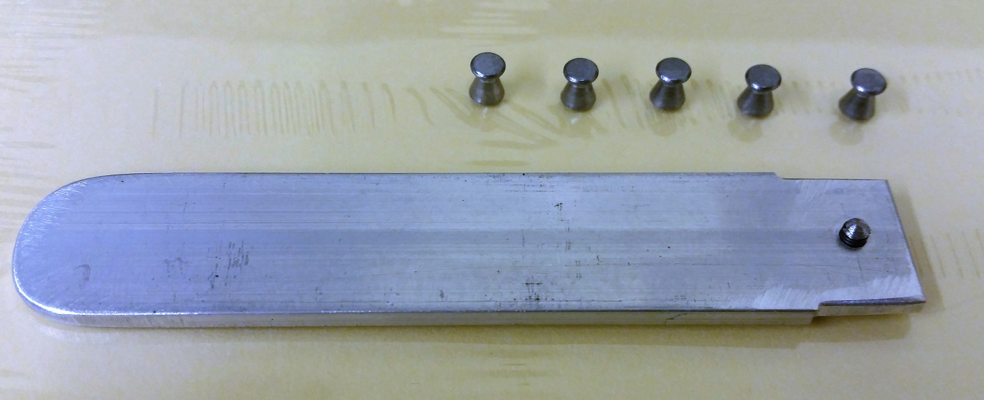

The traditional pellet seating tools do not work with the FAS because it has a hooded breech so the tool is blocked. I don't like using the ball point pen as a tool because it forces the pellet at an angle which must have some effect on accuracy. I made this seating tool from a screw and scrap of aluminum. I pointed the screw so it would push against the waist of the pellet and not the skirt. It is short enough to fit inside the tin of pellets so it can't scratch up the gun in transit.
Since I have been using this tool to seat the pellets, have not had any misfires with it.

OK so using a seating tool makes it cope more frequently but there is fundamentally something wrong here. You should not need to seat pellets in an FAS 60(0)4SPPcoach wrote: I had an identical problem and others here are experiencing the same thing with their FAS 6004.
I can think of several reasons (may also be mentioned elsewhere)
1. Pellets too large - try a tin of R10 4.49 7grain pellets
2. Breech seal poor - move the barrel a tad towards the breech, Check breech face which is the one feature of 6004 that can let it down where the 604 has a machined face.
3. Valve occasionally sticks. Can be dirt or sometimes the hammer spring cross shaft can break.
4. Seal leak somewhere. To test, cock without a pellet and fire immediately. Cock again and wait 2 minutes and fire. Is it the same bang or noticeably quieter?
With 3. and 4. I suggest a strip, clean, polish the valve stem, lube and reseal
https://www.youtube.com/watch?v=q3a1Ma2fcg4
Re: Anybody have a new FAS 6004?
It is not just 'more frequently.' Pellet seating is a sure fire cure in mine.TenMetrePeter wrote:OK so using a seating tool makes it cope more frequently
I think that your number 1 is the primary factor. When seating pellets with my pellet seater I notice that it takes considerable pressure to overcome the initial resistance of getting the skirt of the pellet in the barrel. Once the skirt is in, pushing the pellet further is easy. I have not tried the pellets you mentioned. I have on the shelf R10's, Meister's, H&N econ, H&N plinker and some Crosmans. The results among those brands are consistent. Another poster put up a picture of how the breech is different between the old 604 and the new 6004. The old breech has a noticeable forcing cone like a revolver barrel. The newer barrels do not have that.TenMetrePeter wrote:1. Pellets too large - try a tin of R10 4.49 7grain pellets
2. Maybe. I haven't moved the barrel and I don't intend to. Seating the pellets has always worked. Moving the barrel has a downside risk. Without the tools to properly measure the gap and have a way to reset it back I risk making it worse. It is working now.TenMetrePeter wrote:2. Breech seal poor - move the barrel a tad towards the breech, Check breech face which is the one feature of 6004 that can let it down where the 604 has a machined face.
3 & 4. When shot and it 'misfires' the mechanics are very audible. The air discharge is very noticeable but the pellet does not come out. If I immediately open the breech, you can hear a BIT of air escape when the action is opened. This tells me the breech seal is doing its job. It did hold pressure when the valve released. If I then use the pellet seater, the pistol fires correctly the next time. It is good to know about the vulnerability of the cross shaft. Thanks.TenMetrePeter wrote:3. Valve occasionally sticks. Can be dirt or sometimes the hammer spring cross shaft can break.
That is something to try. Cock it and then chronograph it after waiting a few minutes to see if it has lost velocity.TenMetrePeter wrote:4. Seal leak somewhere. To test, cock without a pellet and fire immediately. Cock again and wait 2 minutes and fire. Is it the same bang or noticeably quieter?
I have not disassembled it. I will watch the video you posted. Thanks for that.
