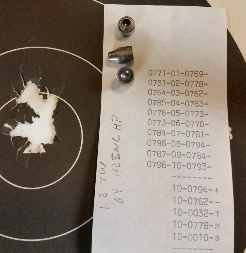

A while back, I did some testing with swaged bullets. A fellow shooter liked my results and bought a swaging press and some dies.
In the photo attached is a group fired at 50 yards. He did not say if it was sand bag rest or Random Rest. I suspect sand bags, as he is a High Master and made comments about adjusting his RedDot for 50 yards.
The bullets in the photo have a hollow point and cup base (slight dimple) at 0.314"
Nonetheless, most impressive!!!

Swaged bullets almost always seem to be excellent, mainly I guess because of the consistency and that they can be made out of very soft alloy. I also think a hollow point is a good idea but trying to cast an accurate HBWC or hollow point never seems to work very well. Were the bullets swaged from wire or cast first and then swaged.
pistol champ
Posts: 132
Joined: Thu Dec 25, 2008 4:35 pm
Location: Eastern PA
Re: Pardini HP 32, ammo talk
Post by pistol champ »
They were made from 92% lead 8% antimony. Big pain to cast slugs with out any tin.
The swaged bullets were 0.3148" final diameter.
Star brass with about 10 reloadings.
Bullet weight 64 gr.
1.3 gr TiteWad
Sizing die 0.3333" no expander used just a small flair of the case mouth to start the bullet.
No crimp just removed the case mouth flair. Bullet is held in place with the 0.001" interference between the case and bullet.
45/45/10 lube
Winchester primer
Overall length 0.875"
Loaded on Star Universal press.
I could never got pure lead to shoot with the cup base. I think that the edge deforms when exiting the barrel and sends the bullet off course. I do get good results with a flat base.
