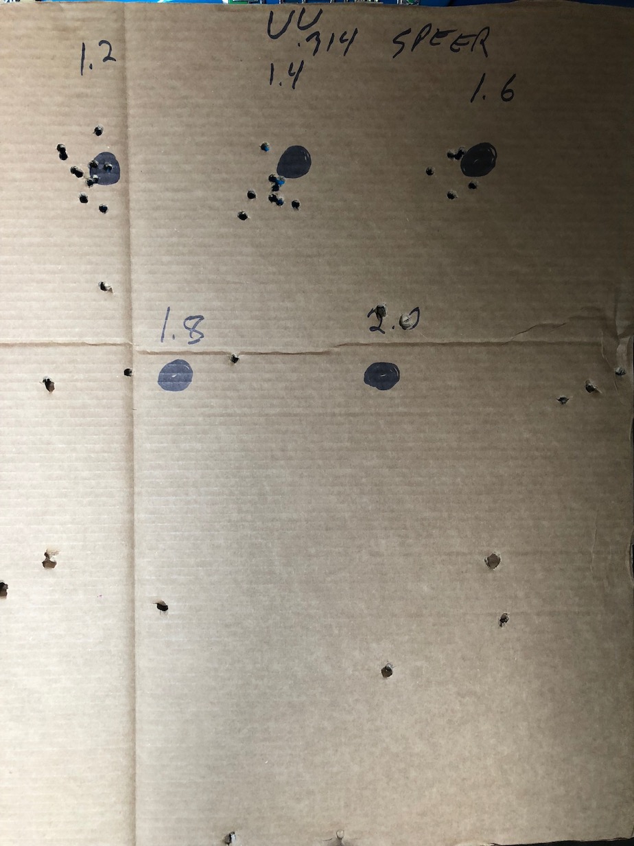

Need some advice . Loading Speer .314 HBWC 98 grains, the grains on the target are Vihta Vuori N310, COL is .894 , Starline Brass . The gun is a 32 auto Pardini. Notice the holes in the cardboard below the top 3 dots. I didn't shoot down there . It has the be flack form the bullet . What is causing this?
Target
Target

Yonak, I’m not sure which holes you mean? Theres lots of holes below the three dots?
The Speer Plinkers usually measure less than the advertised .314, I get .312-.313. Although the Speer is a pretty decent bullet, it’s not the optimal size for the pardini barrel, which is more like .314.
What distance are you shooting, and what procedure (I.e. hand held, benched, Ransom Rest, etc.)?
I’ve never noticed flack from the my bullets, when it happens to me, it’s usually the AH next me to at the range playing Terminator with a shotgun at 7 yards.

Shooting 25yards , benched , anything below & in the writing 1.8 2.0 is flack, Some of it never penetrated the cardboard.

Wow, any chance they could be light powder loads? They look the same size as the other holes.
Otherwise, never noticed anything like it.
I just focused that you are perhaps referring to the Pardini 32 S&W long (I think this thread is focused more on the 32 ACP). Have you experienced this with other bullets, or with the Speer bullets on other occasions?

To clarify, you say you are loading Speer 98 HBWC in a 32 ACP case?
If so, you are in uncharted territory.
Telephone PardiniUSA and ask them what they recommend for the 32 ACP.

If you are loading a 98grn HBWC in a 32acp case, you will have compressed to powder significantly causing high pressure resulting in the projectile separating. The wild holes down below will be the skirts of the projectile.
You must pull any of these rounds and use the popular 62grn semi wadcutter as listed on many of the previous posts for the Pardini 32acp.
Hopefully you havn't bulged the barrel.

Wow, good catch! Big difference between.32S&W and .32acp. Surprised he hasn't blown cases and the extractor out.
