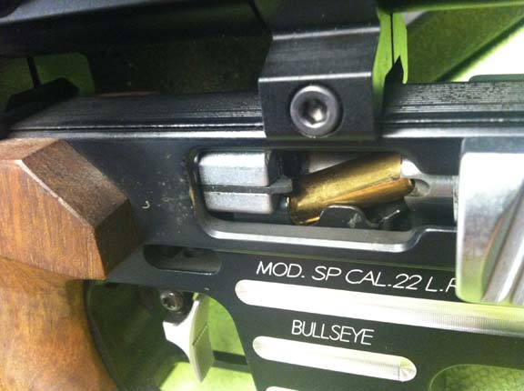

I'm having failure to feed with my .32 S&W conversion on the Pardini SPBE edition gun. 95% of time it is last round but sometime happens second or third round. The failure is the tip of the round hits top of barrel chamber and rim of round is still in the magaznie lips. Frequency is about every third of fourth string. Slow and sustained fire.
Happens with all three of my magazines.
Tried a roll crimp instead of taper crimp.
Charge is 1.5gr of N-310 this charge worked fine for several weeks before problem started.
I tried removing a few more coils of the recoil springs but don't think I should go any more light than it is. I had an extra spring to experiment with. This was the trick to eliminate the problem when I first got the gun. ended up with a spring with about 6 coils shorter.
Any ideas from someone who battled this problem?
Pardine VM is full so guess they are out at matches.
I'll try to attach a picture.
Thanks everyone,[/img]

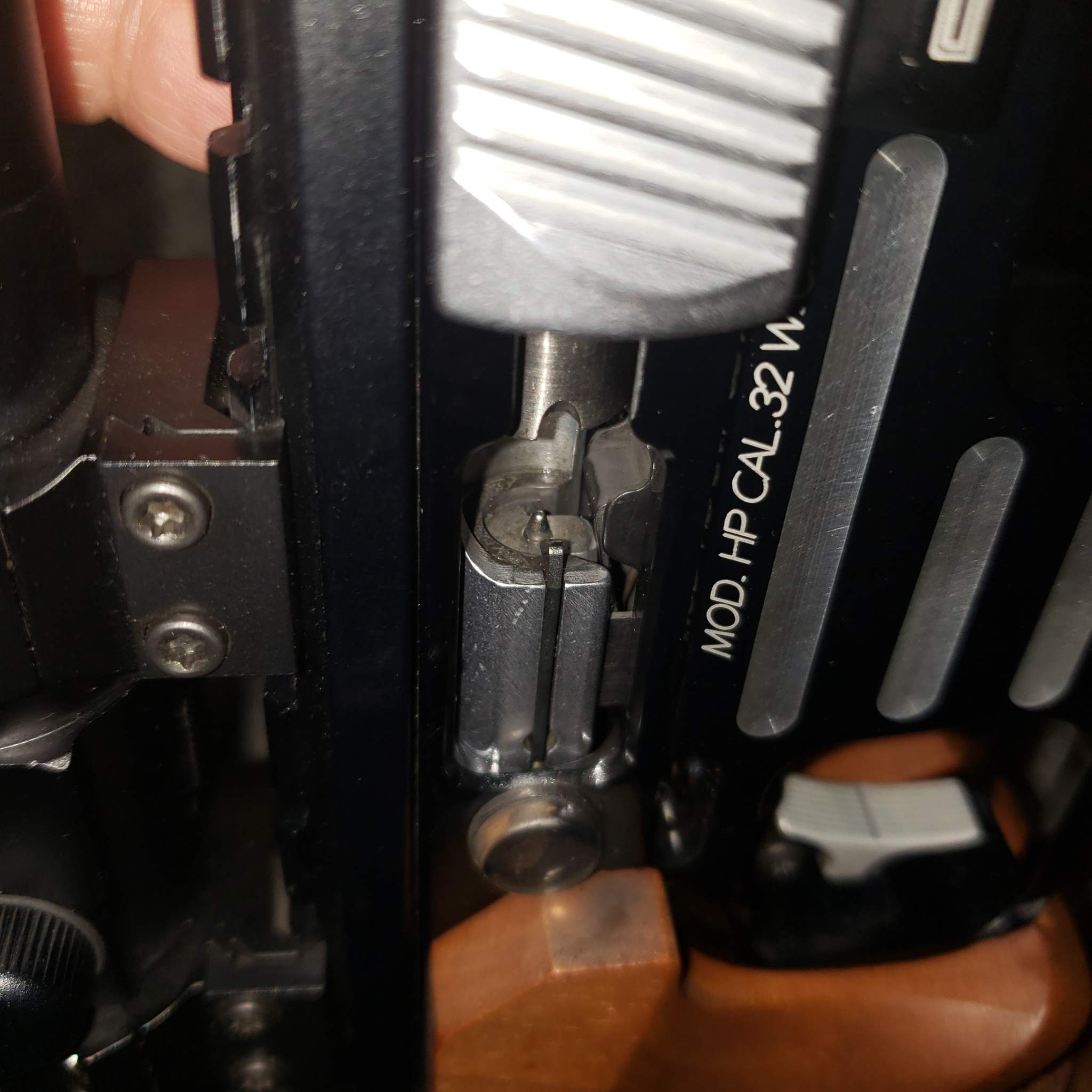

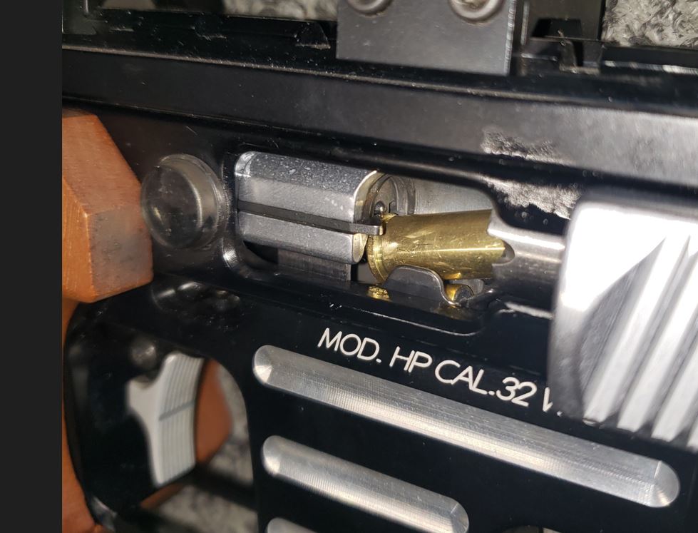

I have been having this exact problem for about 4 weeks. I have done extensive trouble shooting with clips, crimps (changing bullets (H&N, Lapua, & Meister), bullet seating depth, amount of crimp, and taper vs rolled). Normally, this is my favorite centerfire pistol. It just shoots on call and with hardly any movement.
But, earlier this year, my 32 S&W L Pardini started exhibiting other unreliability issues - bolt chatter, failure to eject (same jams as described here - https://www.bullseyeforum.net/t14472-th ... i-sp-be-22). Ultimately, I replaced the ejector spring, buffer pad, and recoil spring. And, the gun was back to cycling flawlessly in competitions.
Now, back to the recent stove pipes as others have described fixes for above, I have spent many hours over the last 4 weeks troubleshooting. But, nothing seemed to help. It turns out that I had a different issue. Perhaps the pictures will help others resolve a similar issue.
Here is a better look at the bolt face, showing the firing pin protruding and that should not happen.
All that work to no avail fixing nonissues. A broken firing pin was the culprit.
Posts: 1636
Re: Pardini SPBE .32 S&W failure to feed problem
Firing pin is broken
