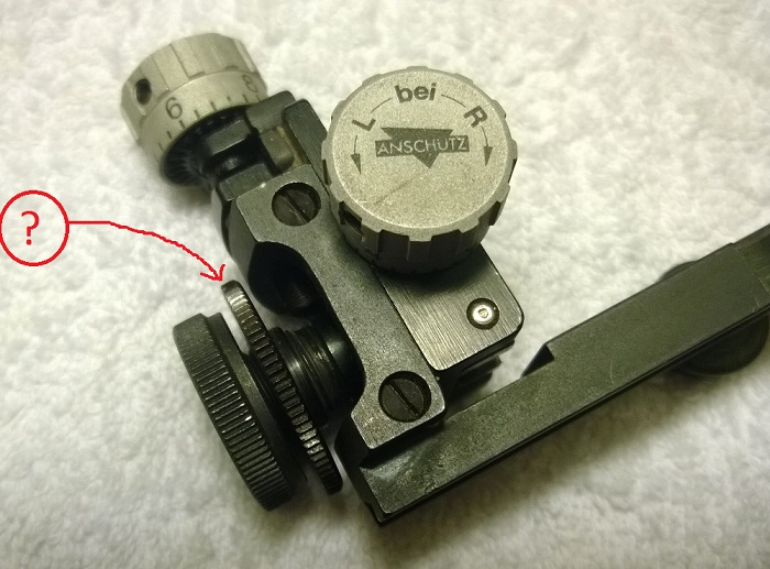

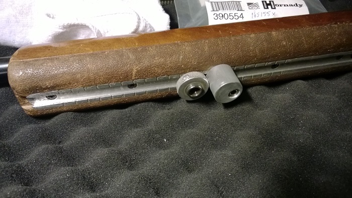

Two gear questions:
- What is that ring in the rear sight? Marked with red arrow and (?)
- I shoot with thin leather glove that is made for everyday use in winter and not for rifle shooting. Since the shooting belt attachment ring was pressing against my hand and causing some pain, I searched the internet a bit and found pictures of different hand stops. Made one from 25mm aluminium round bar.
One older shooter at the shooting range tells me to remove the handstop I made and use the Anschutz part (also in picture) others say nothing. What do you say?

Posts: 2030
Hi Jiri,
the extra ring in the rearsight is to hold a blinder/occluder (to cover the non-aiming eye). The ring is screwed back against the eyepiece holding the blinder in place.
The larger handstop looks fine. There are many commercially made handstops, all of different shapes and size, so it's impossible to say which is best. Some like a very small stop (like the factory one in front of yours), others like something larger. So long as the handstop is not too large for your hand, is comfortable to use, and lets your wrist be straight use whatever you like.
