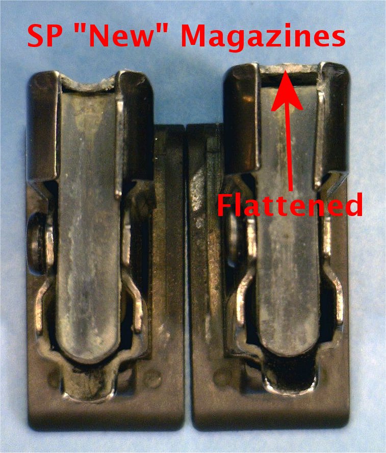

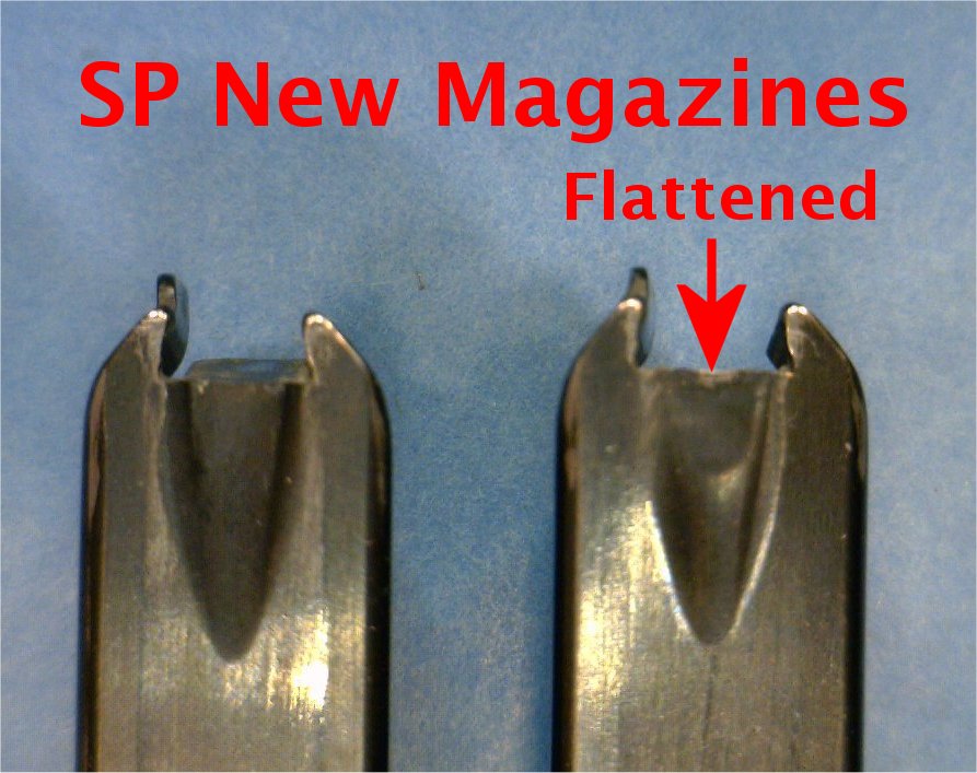

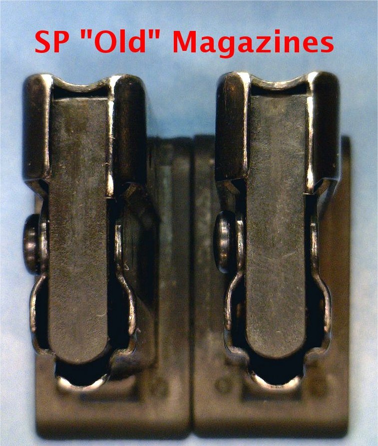

I took some magazine pictures. In the process, I discovered that the modified magazine is actually for my SP New, and all of my wife's SP (old) magazines are unaltered. Her pistol was bought in 2002, and it has the cast ribs AND the 1st stage weight adjustment, so yours is at least a little older than that. Her are what her magazines look like:
My Pardini is a 2008 vintage SP New, and the magazines are slightly different. Here are what mine look like, including the flattened one:
I've shot CCI and Aguila Subsonic in this pistol quite a bit, and never had any issues with feeding. I've never noticed any difference between the flattened one or the regular variety. I hardly ever clean my magazines other than swabbing out the fronts while holding the follower down.

Looks like those "SP New" mags have a bit of a feed-ramp at the front of the magazine too. This would make them perhaps a bit less fussy about the round tipping up to clear the edge, although it doesn't look possible to modify the older ones like that. Maybe simply taking off a bit of material at the front, or rounding the inside edge?
Posts: 3242
Re: Pardini Questions and Answers
There is a ramp on the old magazines, it's just shorter. The biggest visible difference between the old & new magazines is they extended that feed ramp a bit on the newer ones. To make that work, they also had to cut the channel in the frame at the front of the magazine well deeper. The difference isn't huge, and I suspect you might be able to get most of the same benefit by carefully filling the extended ramp down on a new magazine just enough to fit in the older magazine well.
I haven't studied it carefully, but I think there may be a bit more of a radius at the bottom of the chamber on the newer pistols, and I seem to recall hearing of a gunsmith that has increased that radius a bit on some SP's to help feeding. My wife's older SP has never had a feeding problem, so I haven't investigated that option. As a matter of fact, I've never seen a feeding issue on any of the SP's I've dealt with. It's always jams with trapped brass & other extraction issues.

Makes sense. Just observing that because the OP found that the longer rounds showed the issue more often, that the front of the mag may be involved too.
