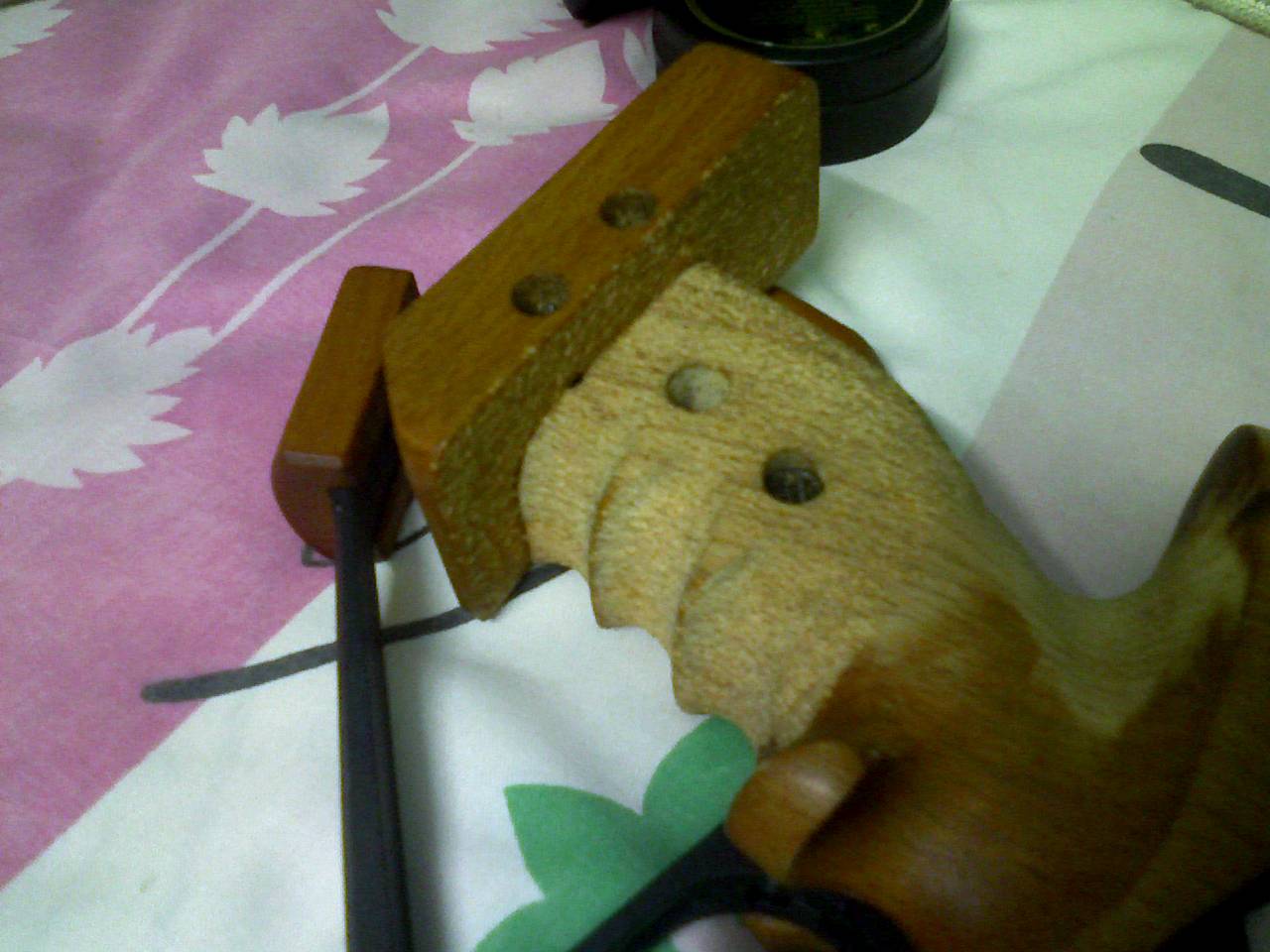

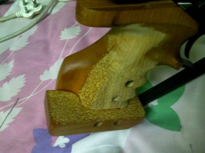

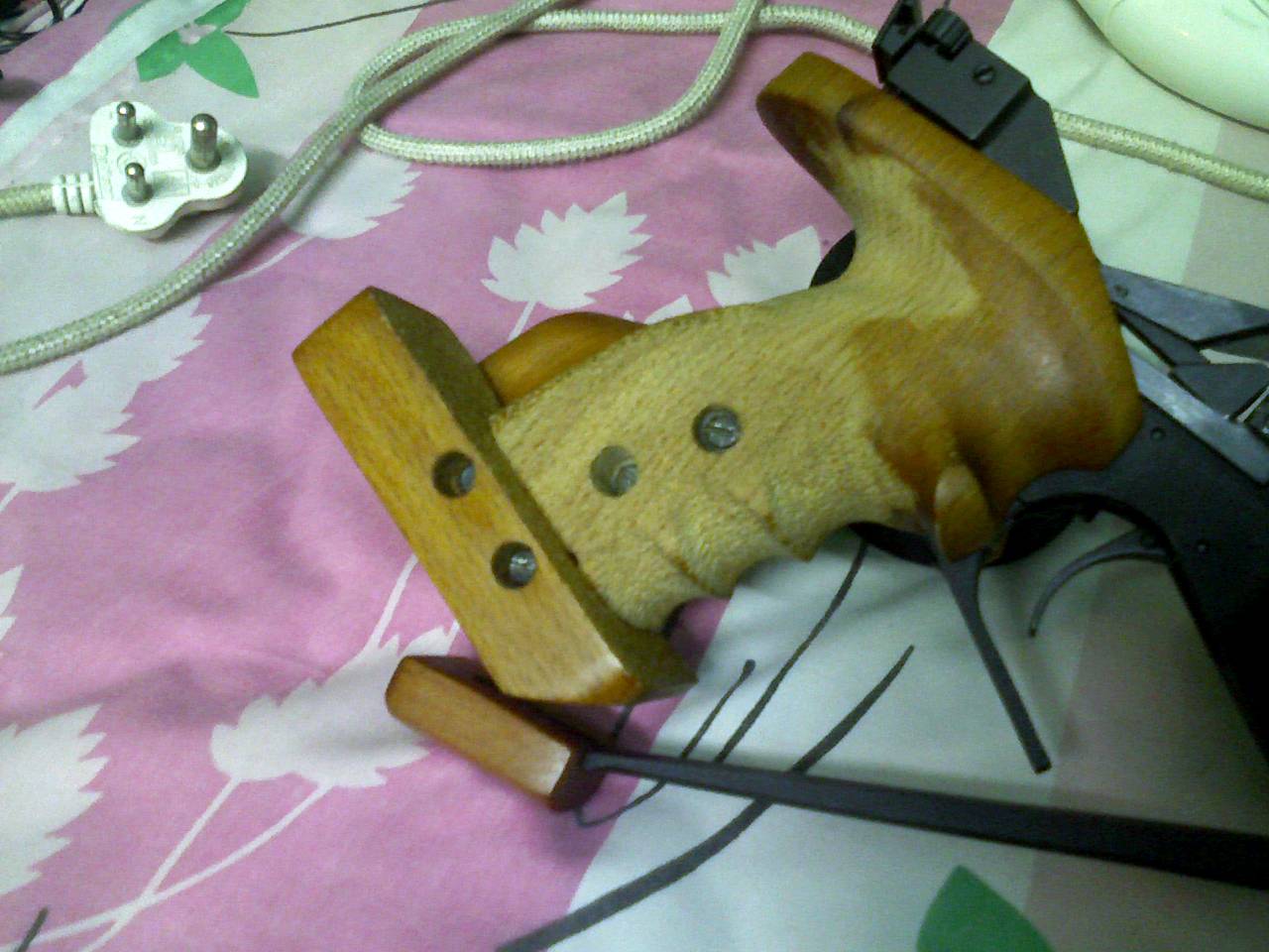

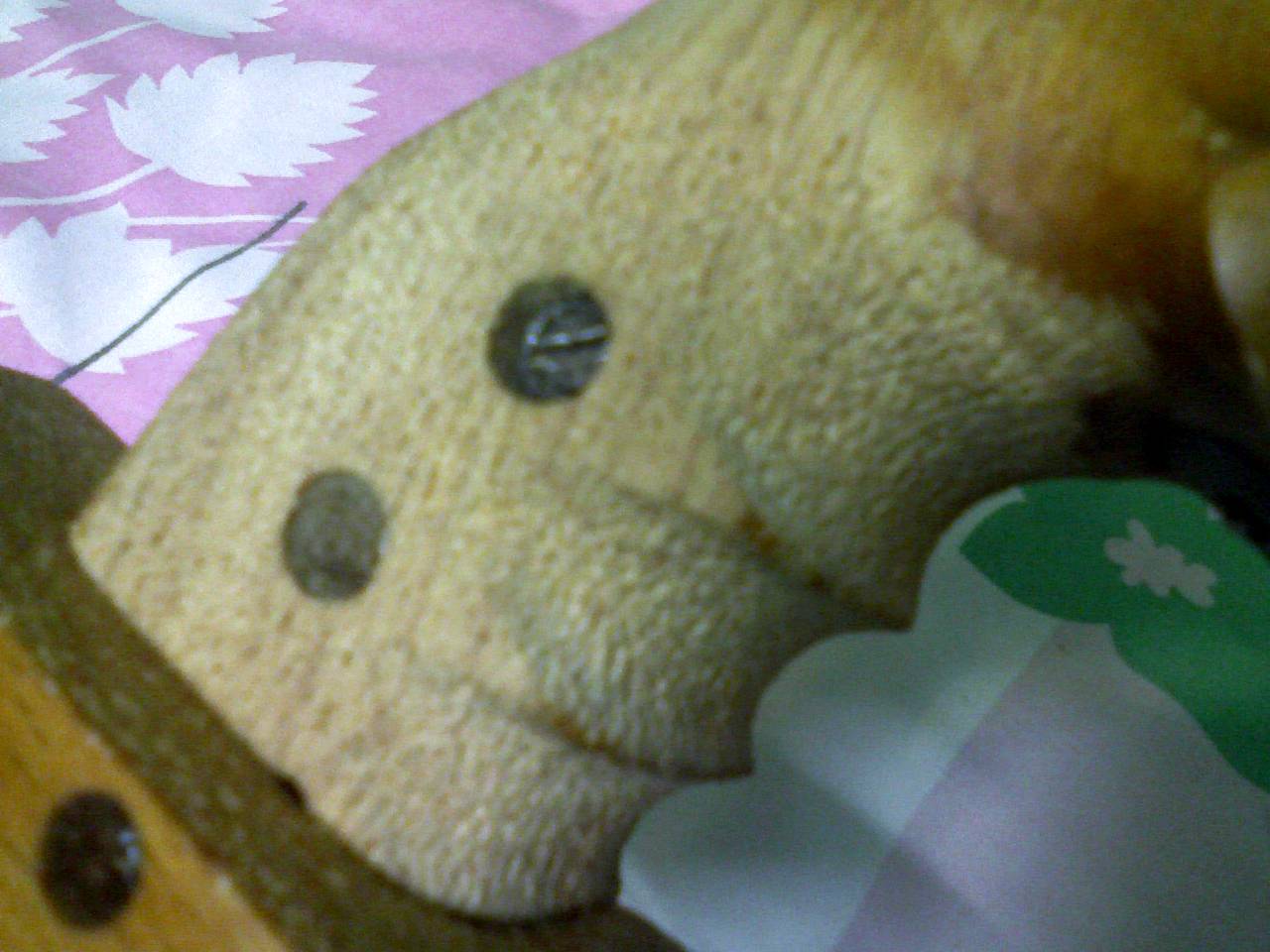

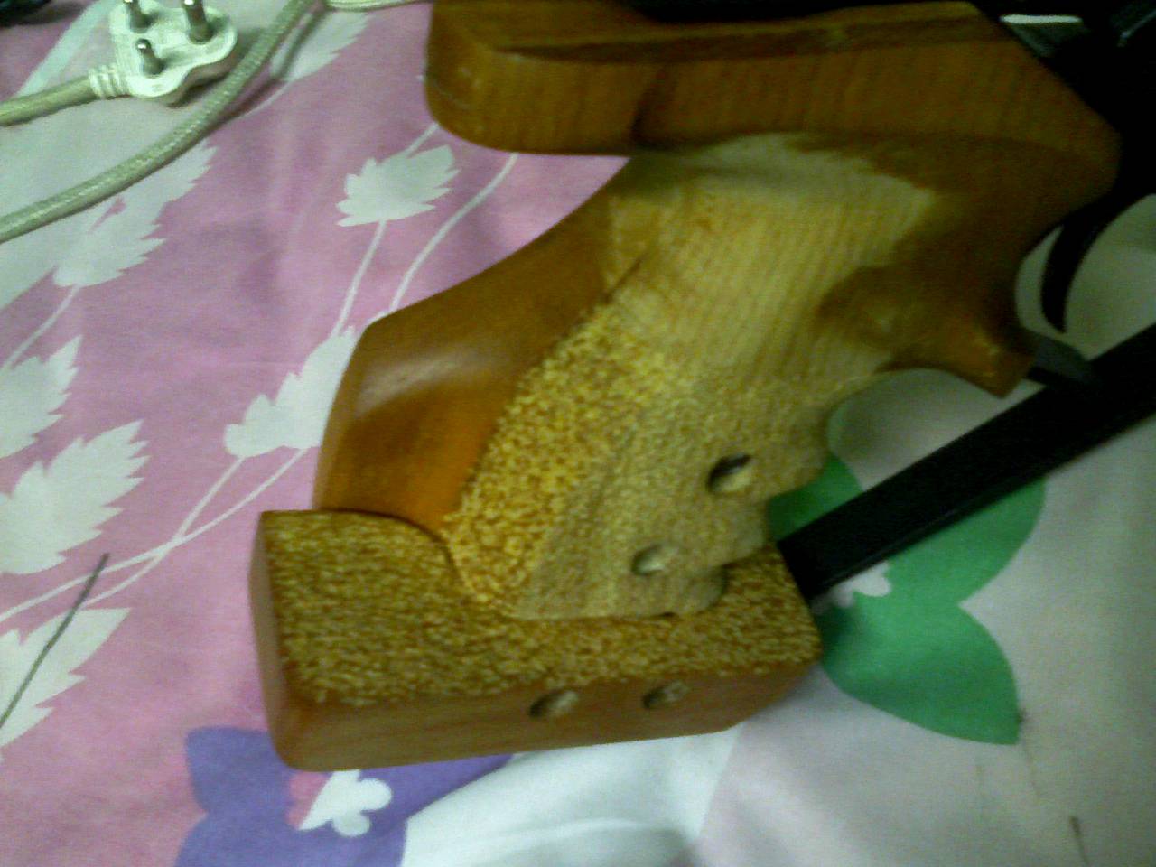

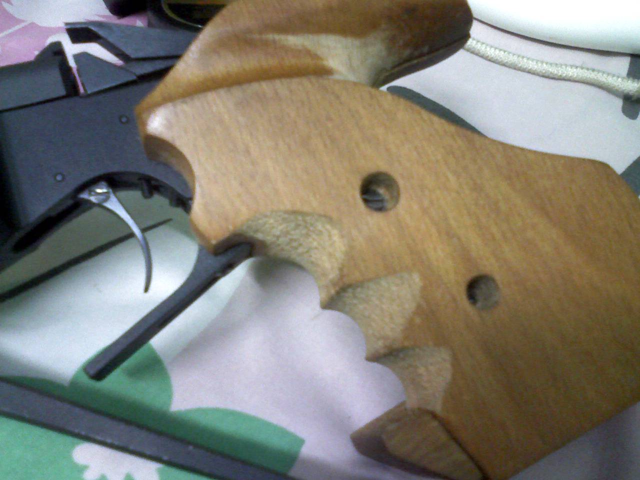

I decided to modify the grips myself and ended up more better than what i was expecting. Now the pistol is really nice to hold. I am thinking, I could have done this much early.
I filed the finger area shape with a half round file and then did stippling with a pin punch.
Few picutres.
rgds,
Gerard

Even just scraping that awful slippery varnished finish off a Baikal grip is a big help, but it looks like you're well on the way to making a sensible target grip there, nice work.

Thanks Gerard, I hesitate to do till now thinking I will screw it up.
Really good now. I am able to repeat the same grip each shot with ease. I think i will hit atlease 10 points more.. not less for sure.
