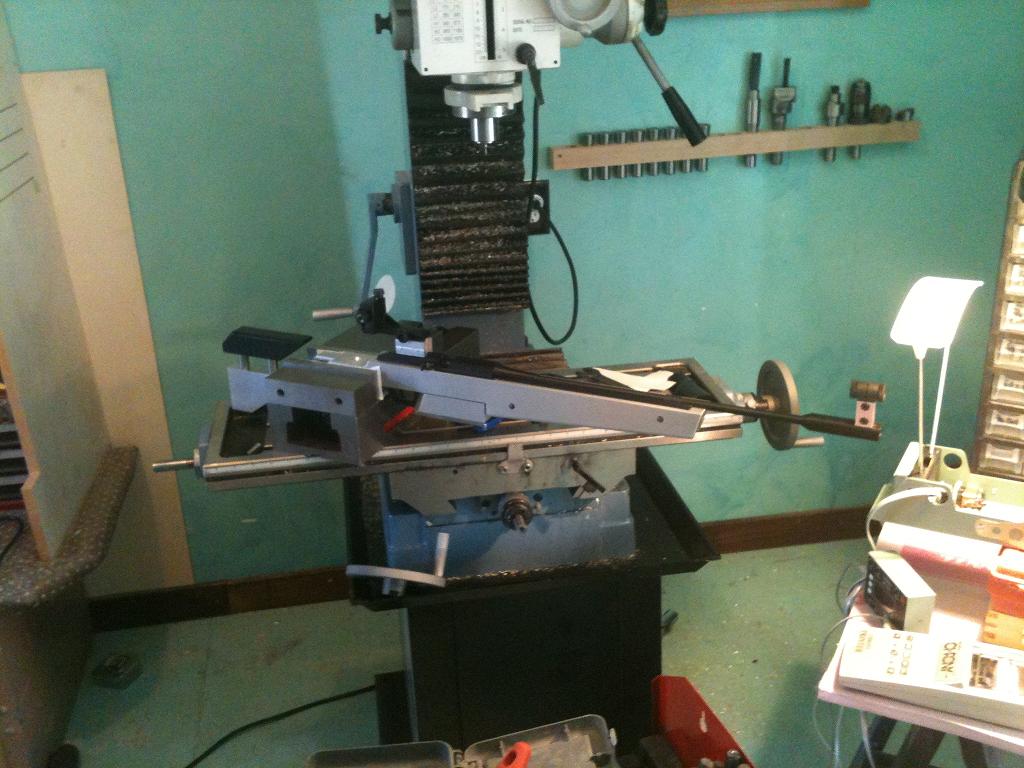

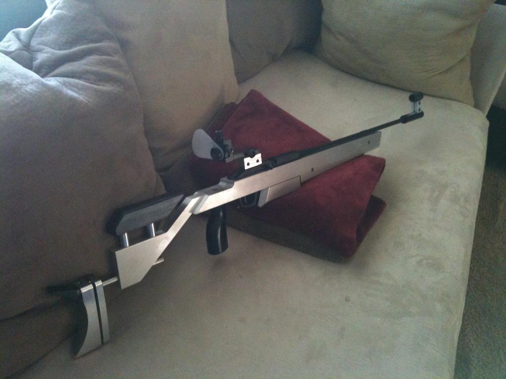

As a side note......I clamped my 753 into the vise on my mill today to check some different pellets. JSB Match Diabolo's 4.50 in the yellow can (8.02gr) were .025-.030 c to c for 10 shots(which I though was astounding, so I repeated the test 4 more times.....same result). I shot r-10's heavies, H and N Match Pistol, Gamo Match and a few different Crosman wadcutters. The H and N's were the next closest at .080 center to center. The JSB's were only reading 430 fps......which was actually the fastest of the bunch. I was bummed out about the slow velocity, but after 50 shots......the worst deviated 15fps max and they kept hitting their mark. The Gamo's were a joke with a spread of nearly 5/8" and 65 fps fluctuations.....worth every penny of their cheap price, I guess....lol.
I was very curious if I could shoot better if I was able to make the rifle fit me like the high dollar ones allow. I made the stock to make it more adjustable for me......it's all aluminum with the cheek piece, grip and top part of the butt in Maple. It bumped the rifle up to 10lbs 5 oz. It balances nicely, and is much easier to hold steady in a very comfortable position for me. The sight risers are wonderful. Not really sporter legal anymore, but it's within the rules of my home range. :-)
Thanks again.

That is a fantastic job on the stock. I have neither the skills nor the tools for that kind of work. I am quite envious!
Since purchasing my first 753 I have converted almost entirely to SSP airguns. I really enjoy their accuracy and enjoy being able to shoot at home.

Thanks for the nice comment on the rifle. I had a good time working on it. If you acquire the tools, the skills will follow shortly.....I promise you that. :-) I cannot imagine life without a mill, now......I use it everyday. I am converting it to cnc, and have about another month before it should be up and running.

I have a set of rear apertures that I machined identical to the Avantis, but with holes progressing from .8mm to 1.4mm by .1mm increments. The holes are very round, as the were interpolated with a smaller endmill on a cnc, rather than being drilled. They are M9 x 1, instead of the M9.5 x 1. I used some thread tape to make them work for the time being. I was happy with the 1.3 rear with the AF front globe, but the larger rear hole made my ability to focus on both the target and the front sight a lot tougher. The target was now a slightly fuzzy blob, instead of the crisp circle I had with the 1.0. I shot crappy with that, too.
So, my conclusion on the front sight is that it's just too big around for my liking at my lighting. It may be great for some other light condition, I don't know. Because of that, I really didn't get to fairly evaluate the inserts. I considered making my own insert of a thicker piece of acrylic, so the band from the countersink would appear wider......but i probably won't mess with it until I try a smaller diameter housing.
I put the Avanti 3.8 front back on and went right back to my low 90's shooting.
The AF rear sight is still very consistent in my opinion......but I'm gonna make a set of truly round apertures in different sizes for it this week like I did for my Avanti......or I may buy an adjustable.
The rear sight is definitely spring loaded, and there is an adjustment screw for the tension. When the aperture is out, you can actually see the spring going at a diagonal downward to the left when the sight is moved way to the right. It's working great, so I didn't mess with it.
If these rear sights are legal on the Daisies for sporter, I wouldn't want to be without one. I'm going to loan mine to the local NJROTC team and see how they like them.
