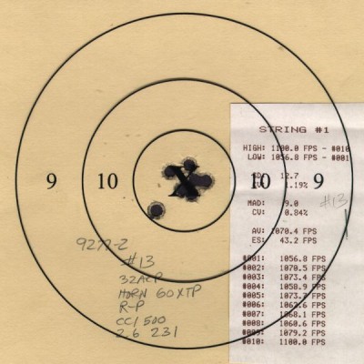

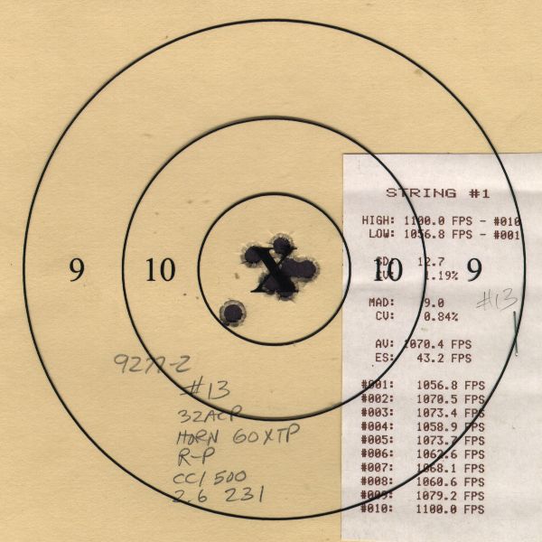

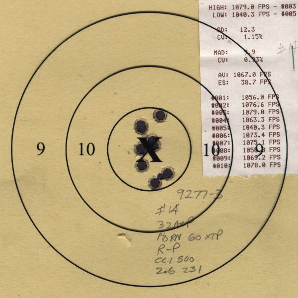

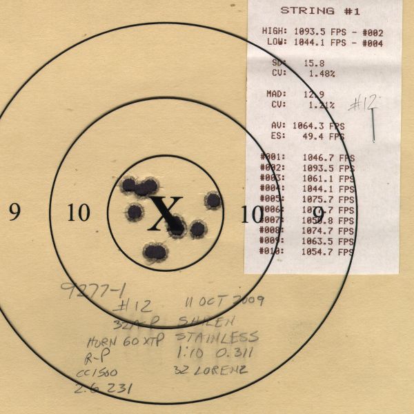

50 yard results of a Pardini HP specially chambered for the 32ACP. Fired from a machine rest.
Hornady 60 grain XTP
2.6 grains W-W 231
CCI 500 primer
R-P Brass
Dave Wilson
Fabricator and shooter of fine 32 barrels.
Target One
Target One
Target Two
Target Two
Target Three
Target Three

oldcaster, no ther are'nt any 32ACP bullseye or CF guns. Thats why I am considering building the concept. Thank you for the barrel twist and bore information.
Hi Dave, very well done indeed !!
Good results with the Pardini HP. What bore diameter and twsit rate on that barrel ?
