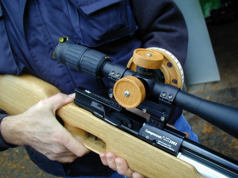

Anschutz used to make model 2020 & 2025, specifically high powered airrifles. (15 - 20 joule). The loading lever was changed for use with a scope. Some time ago I found attached picture on the net, probably a Dutch Field Target forum. From memory the lever would cost some 80 Euro, interchangability unknown.
Regards Hans

I have an Anschutz 2002 that came with both levers. One is for scope mounting. It works fine and is probably still available from Anschutz.
