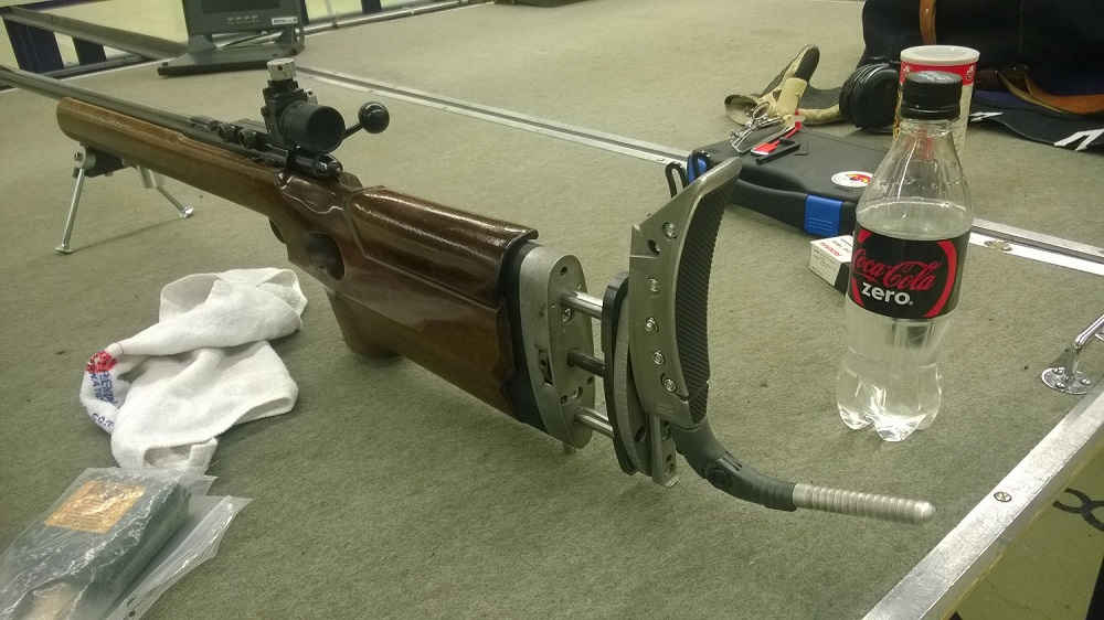

I asked the previous owner of the rifle about the butt modification.
He didn´t make it personally but one other clubmate made it. Reason being that this system gives more adjustment range in tilting the butt plate sideways.
Can you say if this mod is legal by the rules? I´ll read the rulebook to see if there are some rules about this or other things about the rifle.

I stripped the threads on that modified butt plate adjusting thing.
Fixed by drilling and retapping to M8 (was M6) but the hole where butt plate supporting bar goes is somewhat loose. No matter how tight I fasten the screw, buttplate assembly is still able to move a couple of millimeters, mostly up and down. Not good for consistency. wtb parts for original 1613 butt plate mount.

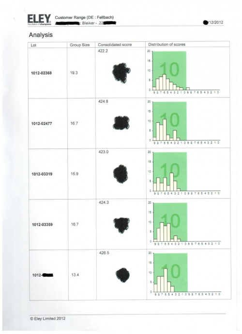

Did some ammo testing today; we have a machine rest in our shooting range.
Got the smallest 10 shot groups with the most expensive (9-12€/50) and least expensive (2,7-3€/50) cartridges. No problem selecting the training ammo from now on as I use TopShot comp. in my 25m pistol too.
But 15 or 16mm edge to edge is a bit much if 10 ring is 10.4mm...
I´ll try to buy/borrow torque wrench and see how proper screw tension affects some of those groups. At the moment the screws are hand tightened to approx. 5Nm. Clubmate said these rifles have a sweetspot somewhere under 4Nm and another at little over 6Nm.

15-16 mm EtE at 50m is not really that bad. Not brilliant but certainly useable. To hold the ISSF 50m ten ring you need to hold a 21.6 mm EtE group. I would think that 15-16 mm EtE would just about hold the inner ten, Although I don't remember the exact size. For EtE groups you add TWICE the bullet diameter to the scoring ring diameter to find the necessary group size.
I think for the Eley test range the record is around 10 mm, 12 mm is considered excellent and under 15 mm is good.
Alan
Alan

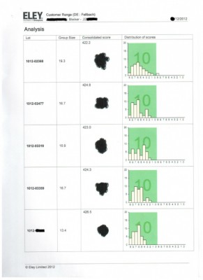

This record on the Eley site seems now a little outdated.
The following picture shows a test on the new Eley test range in Fellach, Germany. This test was posted from a shooter from Poland on the NZL target shooting forum and as far i know this Bleiker rifle was from the former Czech Olympic champion Miroslav Varga.
Here you can read the whole thread on the Kiwi site:
http://www.targetshooting.co.nz/ubbthre ... l#Post2365
But this new record is not the most important thing. It shows only what is possible and what not. The real point is you have to test your ammo for match smallbore rifle shooting and not the brand, the lot makes the difference. If you don't test it is easy possible to get a result like shown in the following thread. And no, such results doesn't general mean the barrel has gone or is bad. I have seen tests with a real good barrel, which shoot with some lot RWS R50 only a score of 95. Even Martynov couldn't shoot more than 570 in a match with such a combo. And no, there was nothing wrong, it was only the wrong lot in the wrong barrel.

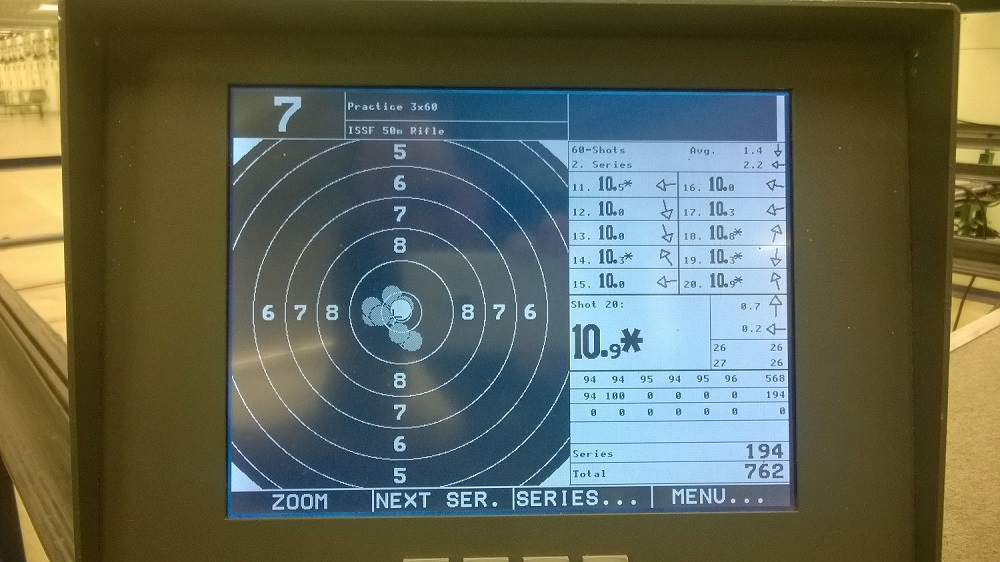

Another follow-up; ca. 6500 shots fired with rifle now.
My competition record in 60rds - 575 and 291 with 30 shots.
Shot another 100p series at Finnish military reserve championship competition last summer :)
Still a long way to go to the winning side of the score sheet, but getting closer..

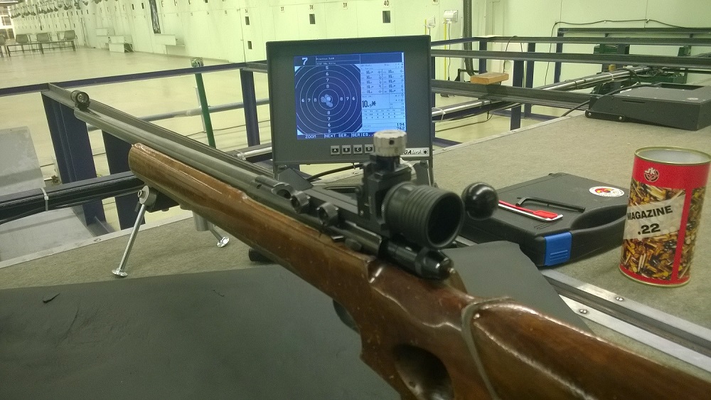

I started thinking about accuracy of the rifle some time ago. So bolted it in the machine rest.
There were some 100p/10 shot series, but nothing magnificent.
