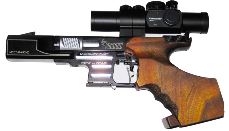

I use the Pardini SPBE 22lr and 32ACP, and a 45 for 2700s and the 22 and 45 for 1800s. I use one scope, a Matchdot II, for both 22 and 32 calibers. This scope has an elevation knob that can be unscrewed and "zeroed."
I use the attached chart to keep track of scope adjustments. Also, if you mount your rings all the way to the rear in the frame groove, you retain your zero if you remove scope for EIC matches. I use Warne picatinny low mount rings, remove the silver-colored insert that is supposed to fit in the picatinny groove, and file the inside (slanted) angle of the ring feet to sharpen them up a bit. I have mounted both rings up front, which moves the center of gravity near the handle (see image; note the rings are not completely to rear in this picture).
So, one scope can work for both calibers. Note: double-check your zero (with the 22) to make sure is correct after remounting the scope. When the elevation knob is zeroed for the 22 at 25 yards, all other settings for 32 ACP loads don't change as they are relative to the 22rf zero. Cool, no? dipnet
