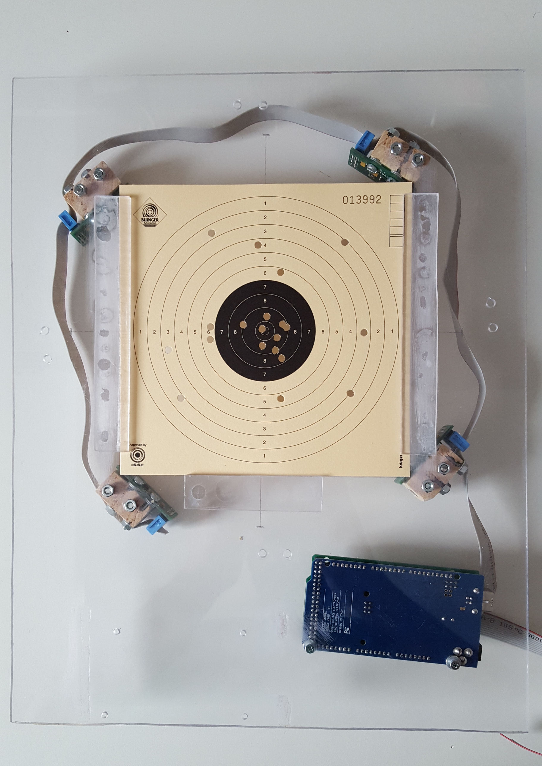

I'm in too. I'm a woodworker so making the boxes is easy-peasy. I'll order the harness within a few weeks.

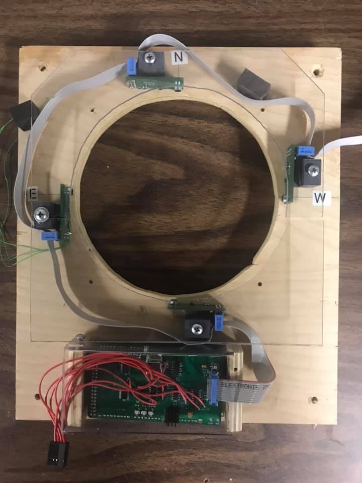

I've been studying the drawings and would like to offer some constructive feedback.
You don't show the depth and location of holes. For example, on the arduino base, you show a 5mm hole but not how deep it is or where it is located. On the sensor mount, you show location and size, but not depth (are they through holes?).
What is the purpose of the target face guides and the wedges you call "target face"?
This is a great start and look forward to making one fore myself.
Re: freETarget
the drawings were made by a third person involved in the project.
i think they are more like a visualization guide line - but yes, they are incomplete (work in progress). the sensor positioning in missing.
the guides on the target face are important to set the paper target - the system uses normal paper targets, not rolls like other ESTs. so the positioning of the target (and it's center) relative to the sensors behind is very important.
i, personally, have not yet used the system. i developed the software using a simulator. now i;m waiting for the electronic boards so i can setup the system at my home and test it.

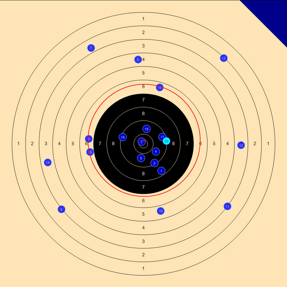

QUESTIONS
probably further down the track
1. how does it handle cross-fires? The suis Ascor (which I am certified for) the jury can discard the erroneous shot - rare in 10M common in 50M
2. and misses (ie strike the target box not the target)
A Sius Ascur indicates a strike outside the measuring area. Perhaps another sensor on the metal target face will pick up any strike that doesn't register?

there are a lot of requests for 50m smallbore setup. for now, we are focused on 10m until we have the process perfected. but there is no design limit to run this for 50m.
there is no provision at the moment for cross fire or box hit. the software would be easy to write. the electronic sensors...a bit more work :)
neither me or the electrical engineer have much experience with the commercial ESTs. can we contact you for technical details on Sius?

Hi Azmodan,
I have been following your work since you first popped up, but something that I may have missed, you say above that you use standard target faces/paper? If there is no roll, what happens (after only a couple of shots) when a hole has been shot through the middle, and from then on there is no hit on the paper?
Re: freETarget
hi
common question :)

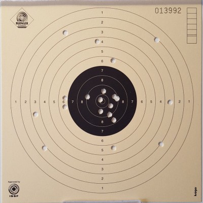

the fact is that the sensors (microphones) pick up the sound wave of the pellet passing by, not the sound of the paper being ripped. the paper is there mostly for aiming purposes, providing a sound barrier and dispute management (in competitions).
so the system works without any paper.
the other issue is accuracy. testing on that is ongoing...
common question :)

The current implementation is an electronic module to collect the shots in the target holder. The electronics connect to the display PC using a long USB cable.
There is discussion about using WiFi, but for now the USB cable is cheap, provides power to the target holder, and is easy to install.
The first cut of the software does not handle cross fires, That is the sort of thing that can be added in once the basic functionality is working. Same goes for the misses.

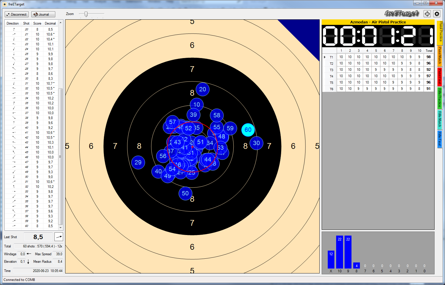

Re: freETarget
Wow! How is the accuracy looking?Azmodan wrote: ↑Mon Jul 27, 2020 12:16 am hi
common question :)

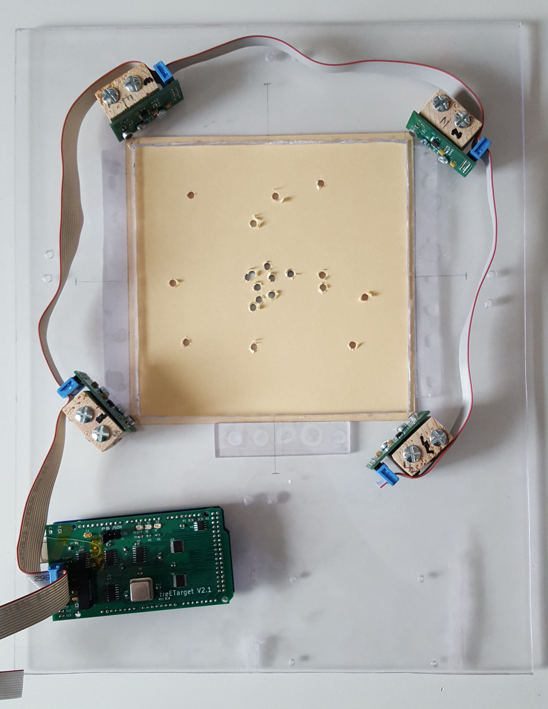

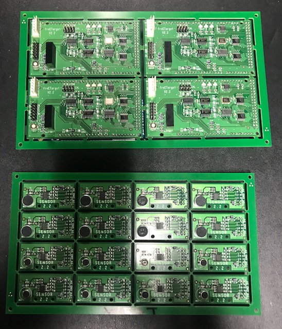

After months of waiting, the first 20 sample boards have arrived.
These are made from production tooling but still prototypes that still need some work.
If you want to try them out, go to the free-e-target.com web site and hit contact us. I will be shipping the first three this week to Colombia, Germany, and the US. After that it will be 2 per week until all the bugs have been worked out.

I was up on your web site reading the theory of operation. It appears from that (I did not read in super detail) that the system has the resolution to discern to a tenth of a scoring ring for pistol. How about for rifle? Seems like it might not have the resolution for a tenth of a point in air rifle is that so?

Re: freETarget
In theory the timing circuit resolves to 0.125us, and since the speed of sound is 0.33mm/us at room temperature, the resolution is well under 1/10 of a point for a rifle.
