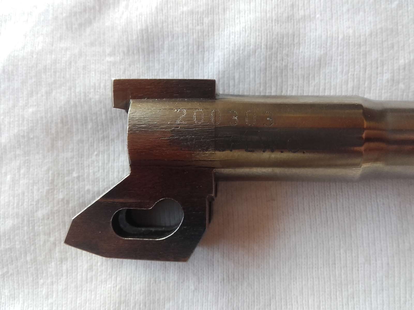

Update time! David found a broker who would get a barrel across the 49 th parallel! So we agreed to do it and after efforts by David and BorderView the P240 barrel landed here this week. I have to say that David is one ABSOLUTELY phenomenal machinist. The quality of his work makes the old Hammerli product look like it was done by the shop apprentice. Superb finish! I had to only polish the locking lug a bit to get it to lock up tight. Then I forgot to lube it. Oy Vay! Testing with my old fading eyes and off a rest showed I needed a sight adjustment but the last mag load went into the ten ring (ISSF 25 m standard target) with four making a single enlarged hole. Color me extremely happy.

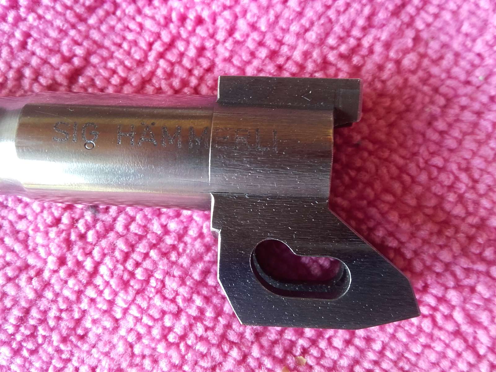

OK just to show off David's work. My old P240 barrel can to me as part of a salvaged gun, I knew the barrel had been damaged, and I was set to core out the breech and install a new chunk of tube. Hesitation kept me from doing it. The barrel had been bulged, the cracks are visible but someone unknown had done a mostly creditable welding job. The pictures show the comparisons (sorry iPad photos) and to show David's work.
Image[/URL]
Sorry could only get two to move here.
Cheers Jim
