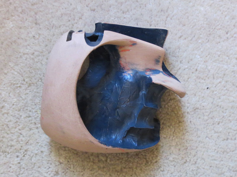

Here in the US, I have bought "Tuf-Fill Mahogany" in the past, out of Ohio. Too bad you have to buy a full Gallon of the stuff. But I found I used most of it over the years. I even created a full, wrap-around Free Pistol grip entirely out of this material. Here is the link...

There's something to be said about aesthetics. The Hardware store epoxies will work, but they come in a variety of colors (yellow, green, red, etc) that you may not like. Further, they tend to set very hard, and are not easy to carve.
The Tuf-Fill Mahogany product mentioned earlier looks similar to what the pros use, is easy to carve, and does not get too hot when setting... you can actually put a glob in the palm of your hand and grab the factory grip. 10-minutes later, you pry your hand loose and it leaves behind a perfectly molded impression that a palm reader can interpret, but more important it usually requires little filing or carving. Add and delete material with ease.
As noted previously, I made an entire grip with it once (top photo).
