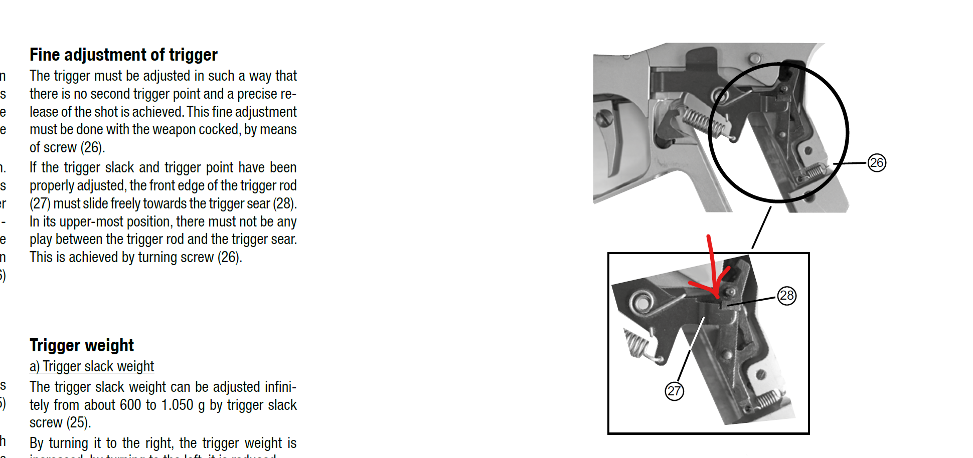

Just finished setting up one of these triggers following your instructions. One question, at the end, how will I know when screw 26 is set correctly?
TIA
Stan
-TT-
Posts: 411
Re: Feiwerbau AW93
Post by -TT- »
This is covered in the manual. You want the minimum gap - almost touching. I marked it in the snip below:
