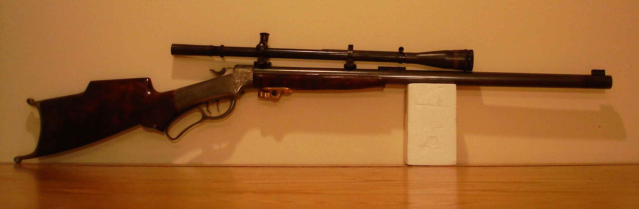

Offline
Posts: 272
Some of us still enjoy shooting 100+ year old Marlin Ballard, Stevens 44 1/2, and Winchester 1885 designs; old school quality.
