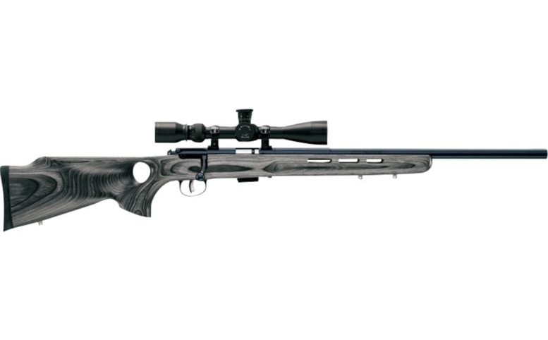

so my local gunshop has that same rifle shown in the picture above. are those actually snow sights that are installed? i did notice they don't have the flip up cover that goes over the barrel and sights. they've got a great price on it so just wondering what other mods for straps and spare magazine holders. can one just carry extra magazines in a pouch or fanny pack or maybe velcro's in a pouch on the stock or something? would the below picture also make a good rifle and could the snow sights be put on these, minus the scope? i checked one of those out and really felt pretty comfortable. i'm basically looking at getting back into shooting rifles again after many many years away and may even think about getting into competition outside of biathlon.

Those Savage sights are not snow sights, but a decent peep and globe sight you can start out with. ESA offers a snow sight kit to retrofit the rifle for about $250?

I know the snow sights have the flip up covers, but other then that what makes them "snow sights?"

Nothing. The rear sight ESA uses might be a little higher quality and it has a blinder option. Not that you couldn't fit some kind of blinder to the Savage sights. I believe they are the basic Williams sights? But don't take my word on everything, I'm certainly not an expert in biathlon, but I do have an ESA rifle.
