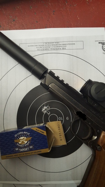

Greetings all. I shot my first match recently. I wrote a long blah blah blah post about it over on an HK forum as I used a (please pardon me) polymer pistol for the CF and 45 portion of the match.
http://www.hkpro.com/forum/hk-handgun-t ... match.html
It isn't a Clark 1911 but I believe it will do well enough for the time being, because...
My real interest in in the 22 portion. I love it. Hooked from the first 10 shot string. I grew up shooting my father's 41 which has been passed on to me as it will be passed on to one of my boys. I currently have a Clark upper on the 41 for competition. It has the tightest chamber known to mankind but it manages to consistently shoot at least 5 rounds before it chokes. I can't complain much as it allowed me to shoot a 557/600 my first time out with a cheap red dot on top. I suspect it will get an Ultramatch RD soon and otherwise truck on as it sits. Attached is a photo of the best group I managed off a rest when testing a few different types of ammo.
So I said all that to say I'm lucky enough to have stumbled into also having an old Hamden HS Victor I picked up on trade a few years back. It has sat in my safe until last week when I remembered that I might have another Bullseye pistol.
The Victor is a bit jammy - it is my understanding that they tend to feed a particular round well once tuned, but I'm not familiar with them and I'd like to send it to someone who knows what they are doing to go through the gun and tweak the mags as necessary.
Who are the better Victor gunsmiths out there these days? My usual go to guys all said they don't work on them.
Thanks for any help - I look forward to learning this sport.

What is that on the barrel? what ever it is it is not legal for true nra bullseye matches, as for the high standard, they do good if it functions a 100% but most have feeding issues with the mags.

GunRunner wrote:What is that on the barrel? what ever it is it is not legal for true nra bullseye matches, as for the high standard, they do good if it functions a 100% but most have feeding issues with the mags.
That is my AAC Element.
http://www.advanced-armament.com/ELEMENT2_p_437.html
It is the best money I ever spent on anything gun related. Hollywood quiet on the right host. The relatively heavy steel slide of the 41 and the impact of the bullet are by far the loudest parts of the equation.
For a match, I take it off and screw on the thread protector - but I assure you if you played with it, you'd come away thinking anything less isn't a civilized affair ;^)
I intend to give the HS a chance. If it isn't for me, c'est la vie. I haven't tried it with CCI SV, which would probably be a smart place to start.

I'm not sure what the question is. You have a model 41, its a good gun and I'd use it for .22 comp.
your barrel is a mess though. Why are you worried about noise?

Exactly how does the suppressor make that gun not bullseye "legal". The only thing I can think of is IF the combination of the suppressor and the barrel are over 10 inches AND it was determined that the suppressor was considered a "barrel" under the rules then it would not meet the definition for "open". Barrel comps are legal for conventional, excuse me "precision" pistol and I assume that if the shooter is legal as far as the suppressor ownership goes, then it would be ok for competition.
Can anyone point me to the rule for comment in Gunrunner's post?
