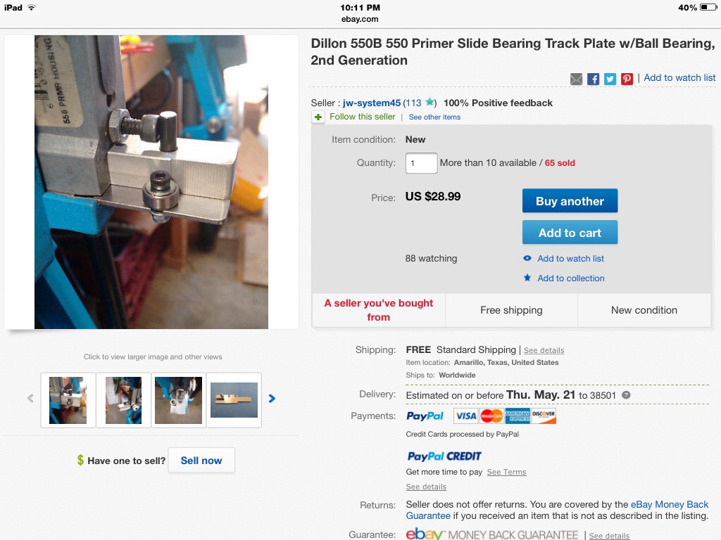

Trooperjake
Posts: 794
Location: Cookeville, TN
Re: Dillon 550 Accessory
Post by Trooperjake »
Isabel
I have included a screen shot of the one I bought, I think there are more than one person selling similar plates.
