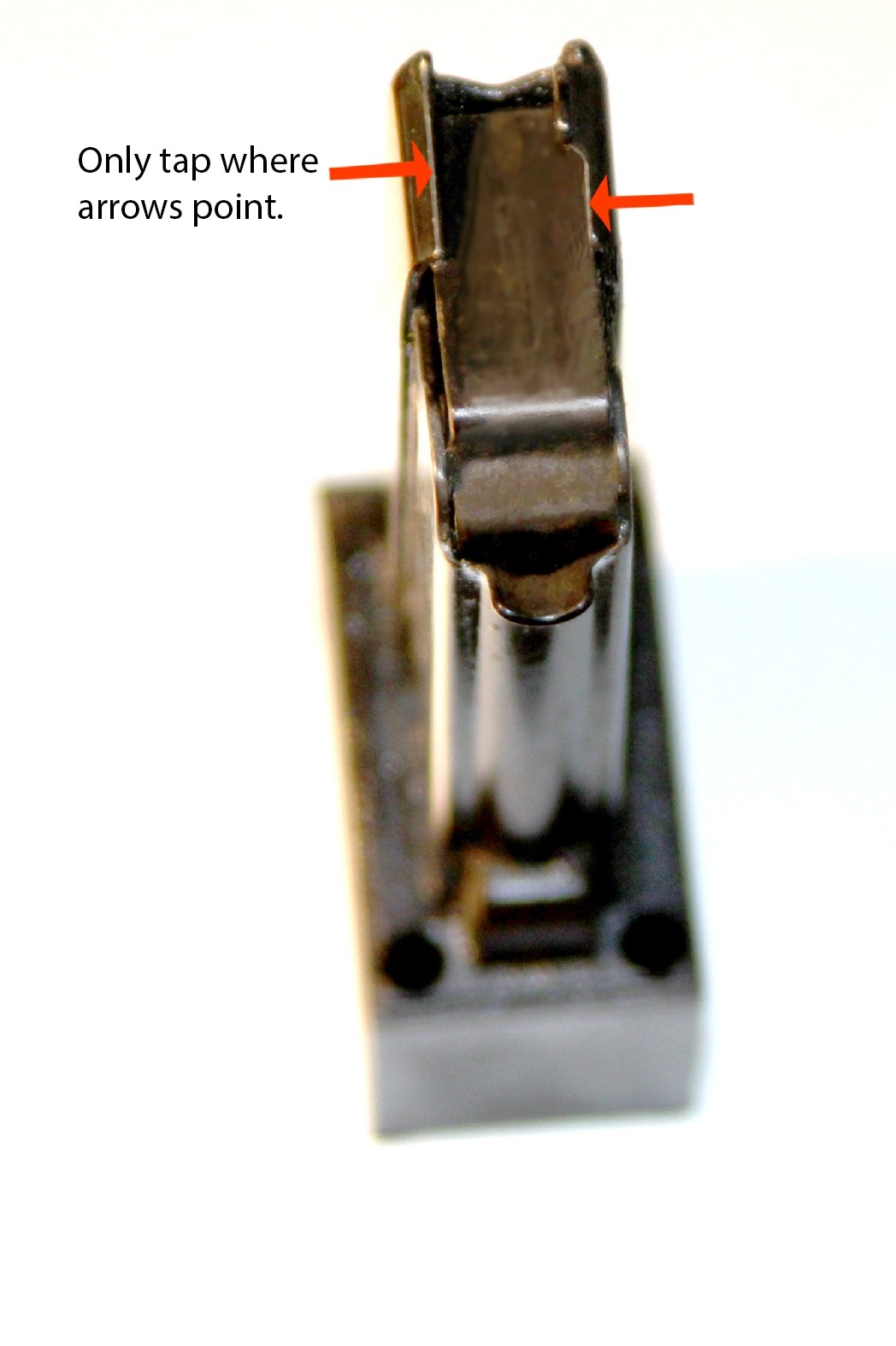

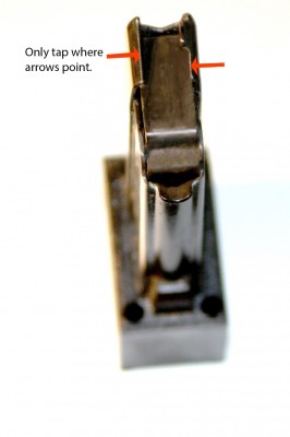

The latest news I have about the 32 ACP is that a group of us has solved the alibi problem. The weakened spring helped but moving the rear edges of the magazines in about .018 fixed everything. I don't know if it will fix it without weakening the spring or using 22 springs because I haven't tried that but the weakening of the spring didn't fix it 100 %.

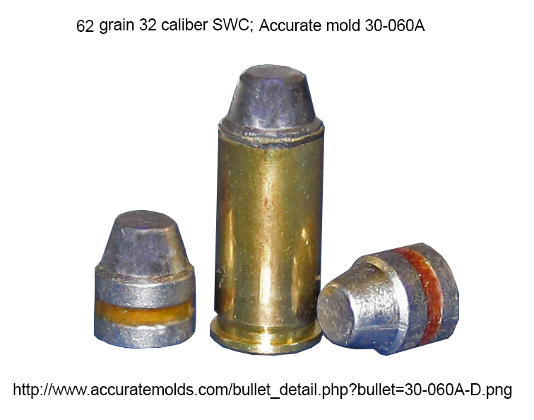

Alibi issue; 62-grain SWC bullet
Post by Dipnet »
Oldcaster is right; the alibi issue with the 32ACP seems put to bed. I shot a match yesterday using suggested remedies and no alibis (very commendable experience). Oldcaster's generosity with the bullet he designed is laudable. The 62-grain SWC bullet is well, cute and appears to be very accurate. It looks like I'm going to take up lead casting. Dipnet
Oldcaster's 62-grain SWC bullet

Can you describe what you did in " moving the rear edges of the magazines in about .018 fixed everything."
I have not found a definitive magazine type yet. Old ones with a flat back and light spring or new with a back dimple and heavy spring, some work and some don't of both types.
Is the mold you use available? I'd sure like to check out your lighter bullets against the Rim Rock 76gn i've been using.

In the post right above yours from Dipnet there is the link to where you can get the mold and which one it is. I went for the 5 cavity aluminum and I think everyone else did also. I like iron molds a lot better but the price differential is too great to go that way.
As far as the magazines are concerned, I put the magazine in a vice (be careful here as the magazine isn't that tough) and with one of them I moved the rear edge of the magazine opposite the ejector in around .009 with a 3/16 inch brass rod by hitting it in and down at an angle of about 45 degrees. Then I moved the other one by hitting it the same way right in front of the ejector.
The other magazine I put it in the vice the same way and hit in the same area with a brass hammer about 5/8 inch in diameter on both sides and didn't use the rod.
One magazine is now .286 across and the other is .283. At this point I have no idea if this is just enough or almost too much other than both work well now and neither did befo. Perhaps some of the other guys could chime in and measure how wide their magazine is at this point. It doesn't take much force to move them in that amount. Make sure you measure what you have to start with and then move each side half way because once it is done on both sides, there isn't any way to reference how much one side has been moved other than just looking at it.

Use a 9/32 doll pin or drill bit as a guide inside

Pic was courtesy of Trooperjake

Old Casters bullet = Accurate mode 060A
Mine drop at .316" I size them to .315"
I'm using 50/50 lube as recommended by Old Caster
